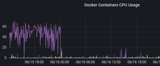

What helped for me was, to disable the “export” of the Glances data to influxdb, restart glances addon, re-enable the export of glances data to influxdb restart addon once more, and afterwards my load dropper from averaging 7 to 2.
I think you can see what InfluxDB is in this graph… :smiley: influx_usage
Running HASS in Docker, Supervised, RPI4 4GB RAM, 64bit OS (as I tried 32 → 64bit which did not help )
