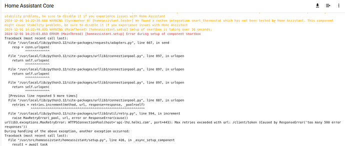

I have the same problem with api-lhz. Did you become an answer?
I found the problem. I had the false auth token. Now itt works with TTI Technotherm.
What did you do to fix it? I still can’t get it working
Hi, is this still valid?
I can’t find the smartbox Python module, the url https://github.com/graham33/smartbox seems broken.
Hi, I’m the only mantainer (kinda) of this integration. These are too working repos:
I’ve using the graham33/smartbox some years (still works), but with the core update to 2025.0.1 core fails because the TEMP_CELSIUS deprecation: Deprecation of TEMP_CELSIUS · Issue #108991 · home-assistant/core · GitHub
Do you updated and maintain the code?
