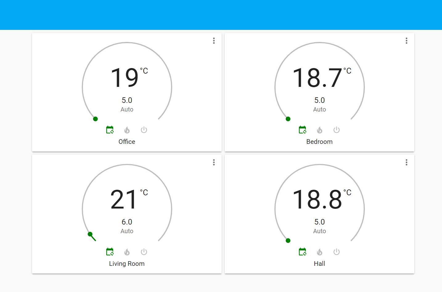

Hi @dadoj thanks for getting in touch. You can see my script on github https://github.com/davefrooney/lhz/blob/752b44496d2f49e6c8926005272c835bf6d0ed4c/climate.py
I have taken some of the hardcoded elements and added variables to the script instead. You will see from my script that I have 4 radiators. I had to add all for of these but I am sure there is a simpler way to do this without all the repetition.
My configuration looks like this. The number increments by 1 for each radiator
- platform: mqtt
modes:
- "off"
- "heat"
- "auto"
min_temp: 5
max_temp: 30
temp_step: 0.5
precision: 0.1
retain: true
qos: 0
payload_on: on
payload_off: off
payload_available: online
payload_not_available: offline
current_temperature_topic: HAVERLAND/devs/htr/2/status
current_temperature_template: "{{ value_json.mtemp }}"
temperature_state_template: "{{ value_json.stemp }}"
temperature_command_topic: HAVERLAND/devs/htr/2/temperature_command
mode_state_topic: HAVERLAND/devs/htr/2/mode_state
mode_command_topic: HAVERLAND/devs/htr/2/mode_command
power_command_topic: HAVERLAND/devs/htr/2/power_command
