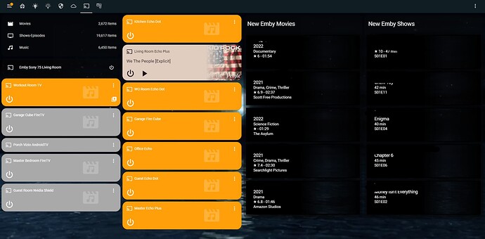

Use case: I have Emby Premiere and Home Assistant for my home and all it’s “gadgets”, I have a Fire Tablet wall mounted in the Kitchen that runs Fully Kiosk browser and goes to the HA dashboard(s). I have a media tab where I can see all the Alexa media player (controls), along with Android/Fire TVs (again controls) as well as the Emby media player controls. Which is nice I can control volume, see what is playing and turn on/off. What I would like to do (for the wife who is not that tech savvy), is display a Live TV channel within an html/iframe card on that media dashboard so when in the Kitchen she can hear and watch on the tablet rather than having to close the Kiosk browser and switch over to the Emby app as that just get complicated and I have to fix.
I have looked high and low and I just don’t see where it has been done or could be I am searching the wrong terms.
I was hoping to do this one of two ways, either directly from the HDHomerun tuner (MPEG-TS) or through an interface to Emby and the live TV component and carve out space on the media page as pictured below along with all other things media.
