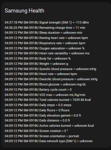

How come most of these values are unknown or 0, for this markdown card?
and from the YAML editor:
type: markdown
title: Samsung Health
content: |-
  {% set sm_sensors = states
     | selectattr('entity_id', 'search', 'sensor.')
     | selectattr('name', 'search', 'SM-S918U')
     | sort(attribute='last_updated', reverse=true)
     | list %}
  {% if sm_sensors | length > 0 %}
    {% for s in sm_sensors -%}
    {{ as_local(s.last_updated).strftime('%I:%M:%S %p') }} {{ s.name }} = {{ s.state }} {{ s.attributes.unit_of_measurement if s.attributes.unit_of_measurement is defined }}<br>
    {%- endfor %}
  {% else %}
    None - No matching sensors found
  {% endif %}
FYI: I have the Galaxy S23 Ultra (SM-S918U) and a very old original Galaxy Watch (SM-R805U) -
Thoughts anybody?
~1,800 view and no replies… bummer!
you replied to a post and kinda changed topics to discuss your YAML configuration that may be why it got missed.
If those sensors have actual values the issue is somewhere in the template.
Are you certain your health connect data contains data for those sensors to begin with?
I can see that total calories burned has an actual value so its most probable the other sensors have no values. On the screen you enabled the sensors in teh app you should see the actual value there.
There is also a known issue where some sensors may stay in the unknown state until either they receive a state update or HA core/app get updated

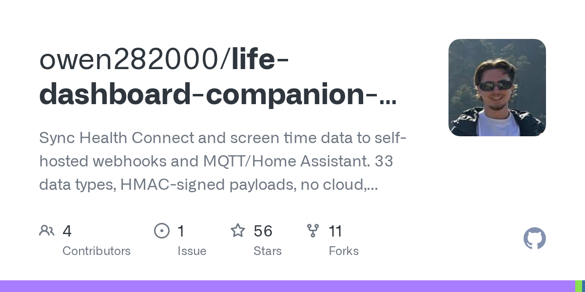

A bit late to this thread, but I think it can still be useful for people looking for a solution to this. The companion app still keeps the latest reading as a sensor, so it can’t add history.
If history is what you want, as I did, I built a separate open source app that does exactly that. It reads the Health Connect data on your phone and sends it to its own HA integration, which writes day totals and hourly ranges into long-term statistics on the dates they actually happened. A backfill of a year shows up as a year of steps, heart rate and sleep. No third-party service is involved, the data goes straight from your phone to your own HA instance. Pairing is a QR code, and it runs next to the companion app rather than replacing it.
