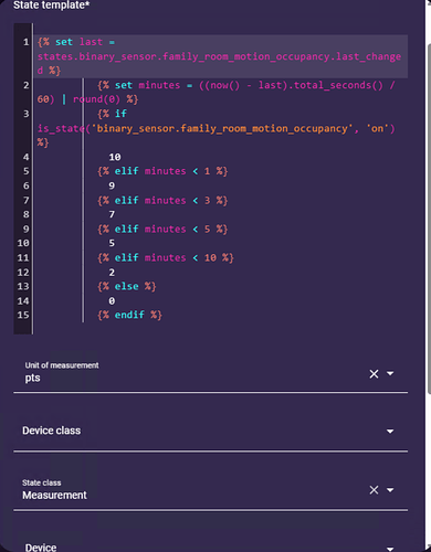

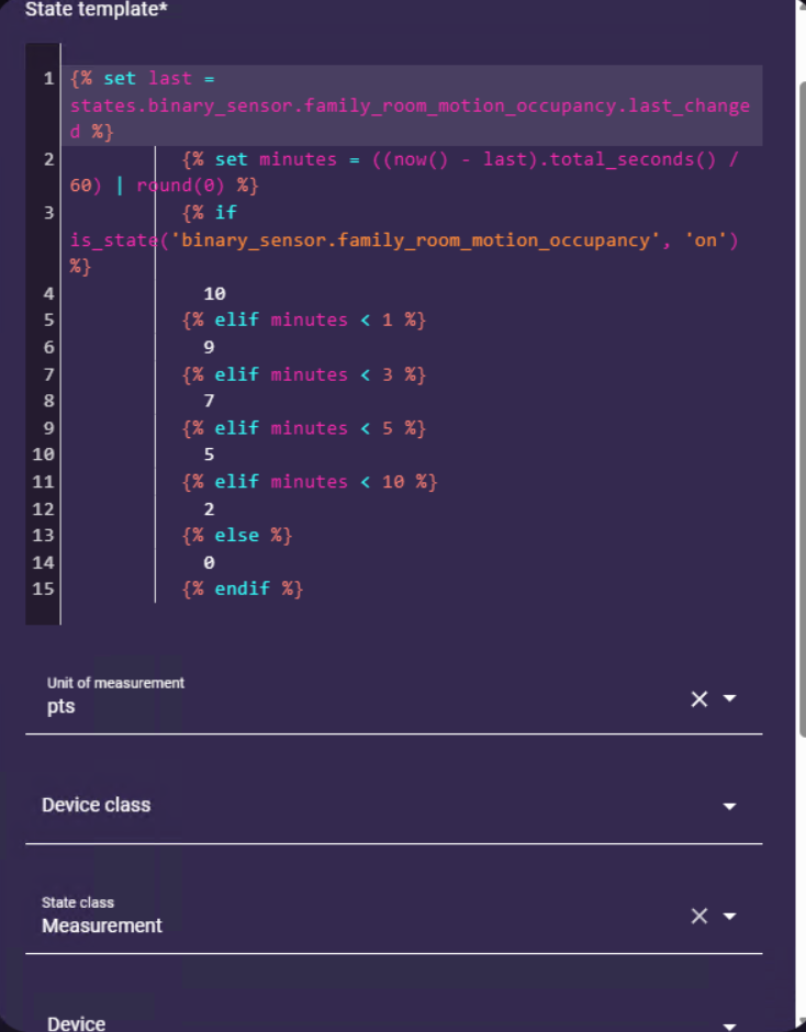

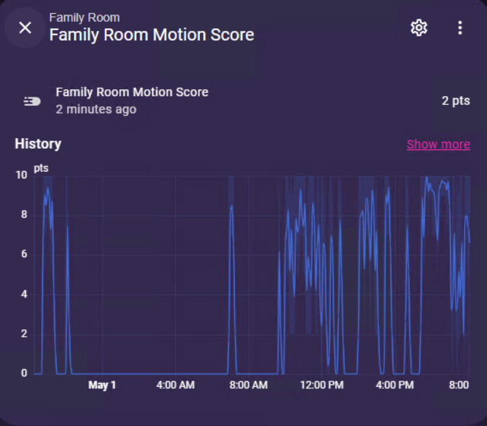

Hi @andsten, I really like your heat map card and have used it with a number of things in my home with a lot of success, but I am having issues with one thing I’m trying to set up. I have a template that I’m using to generate a motion score for the occupancy sensors in my home. The problem I’m running into is there isn’t really a device class I can map these to and the card doesn’t seem to want to work for me with them.
Here is the template sensor. As you can see I do have history and data on the sensor, but the card doesn’t want to work with it. I’ve even tried to map it to some random device classes without any luck. Any thoughts on this?
