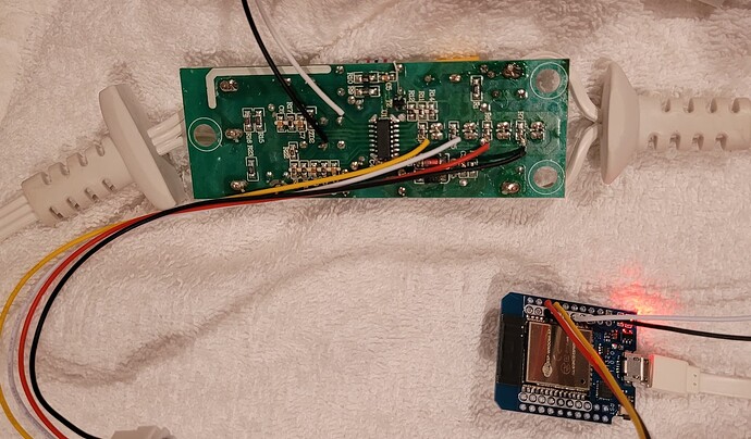

I just finished smartifying my electric blanket. I bought a second controller off eBay, tapped the LED signals, the pull-ed up button sensor signal, and GND on the other side of the button. Hooked everything to an ESP32 (which are 5V-tolerant) and voila!
I defined a helper drop-down which triggers an automation to keep “clicking” the button until the desired power level is reached and Lovelace card for each that select the corresponding power level if not already on or turn off the blanket otherwise when tapped.
The controller remains fully manually working and I’m simply faking button presses. Its internal safety features like auto-shut off are still fully functional. I tried supplying the power for the ESP32 from the controller itself but it didn’t work.
See it in action here: Imgur: The magic of the Internet
binary_sensor:
  - platform: gpio
    pin: 32
  - platform: gpio
    pin: 21
  - platform: gpio
    pin: 25
  - platform: gpio
    pin: 22
sensor:
  - platform: binary_sensor_map
    type: sum
    channels:
      - binary_sensor: warm
        value: 1
      - binary_sensor: low
        value: 2
      - binary_sensor: med
        value: 4
      - binary_sensor: high
        value: 8
output:
  - platform: gpio
    pin:
       number: 16
       inverted: true
       mode:
         output: true
         open_drain: true
button:
  - platform: output
    output: button_press
    duration: 100ms
text_sensor:
  - platform: template
    icon: mdi:bed
    lambda: |-
      if (id(power_map).state == 0) return {"Off"};
      if (id(power_map).state == 1) return {"Warm"};
      if (id(power_map).state == 2) return {"Low"};
      if (id(power_map).state == 4) return {"Medium"};
      if (id(power_map).state == 8) return {"High"};
      return {"ERROR!"};
    update_interval: 1s
select:
    icon: mdi:bed-outline
    optimistic: True
    options:
      - "Off"
      - "Warm"
      - "Low"
      - "Med"
      - "High"
    initial_option: "Off"
    set_action:
      then:
        - if:
            condition:
              lambda: 'return x == "Off";'
            then:
              - while:
                  condition:
                    or:
                      - binary_sensor.is_on: warm
                      - binary_sensor.is_on: low
                      - binary_sensor.is_on: med
                      - binary_sensor.is_on: high
                  then:
                    - output.turn_on: button_press
                    - delay: 100ms
                    - output.turn_off: button_press
                    - delay: 200ms
            else:
              - while:
                  condition:
                    lambda: |-
                      return
                        (x == "Warm" && !id(warm).state)
                        || (x == "Low" && !id(low).state)
                        || (x == "Med" && !id(med).state)
                        || (x == "High" && !id(high).state);
                  then:
                    - delay: 100ms
                    - delay: 200ms

Where does the black wire from the switch connect to on the ESP32?
One side of the button goes to GPIO16 and the other one to GND.
