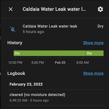

- Optionally start pairing the sensor with your zigbee coordinator and add it to Home Assistant or Zigbee2Mqtt (i use the Sonoff Dongle but it’s indifferent, you can also test if shorting the probes marks the sensor as closed/open. The sensor is pretty reactive!

You can use any custom card you want in Home assistant
I integrated into my alarm sistem automation but you can also trigger Alexa / Google home voice announcements (Alexa Media Player Integration - #3 by playerWon) calling its service via a simpler automation.
