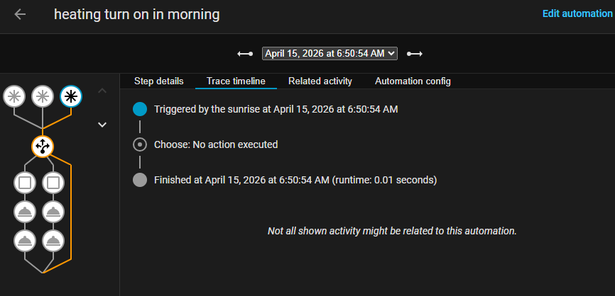

I have also got a screen shot of the trace from this morning.
That trace is for a firing event of the sunrise trigger, which you don’t have a Choose option for…
