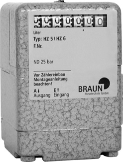

So you can measure the consumption of heating oil using a meter like the Braun Hz-5 Braun HZ5 Heating Oil Meter, 0.7 - 40.0 LPH - Welcome to Oilybits U.K.
(or they do another which has a digital rather than a mechanical read out)
