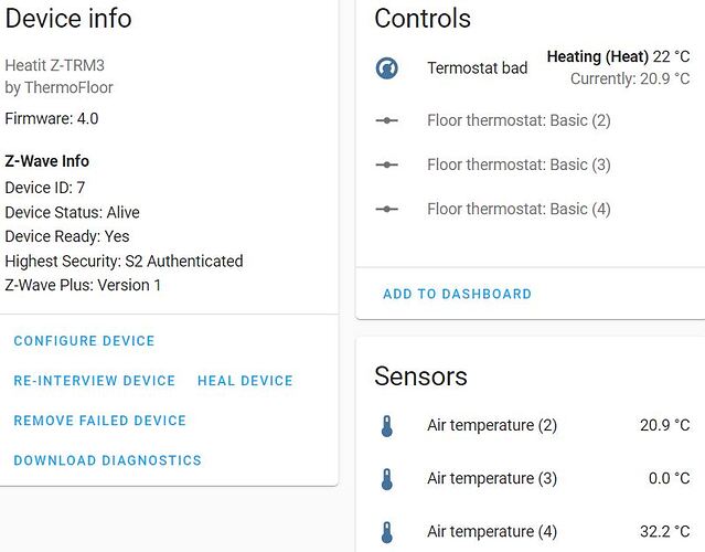

I just installed a Heatit Z-TRM3 thermostat which I try to configure.
It shows up nicely, but I would like to know excactly what is measured
by the different sensors Air temperature (2), Air temperature (3)
and Air temperature (4). Should there be a Air temperature(1)?
I have read the manufacture’s manual and looked at the diagnostics file
with no success. I can guess, but hope for an answer
or a link to some documentation. Neither do I have any clue to
what hides behind Basic(2), Basic(3) and Basic(4) .
Thanks, Ola

I think the temperature sensors are as follows, this matches what it says on page 5 of the manual:
  • air_temperature_2: internal room temperature sensor
  • air_temperature_3: external room temperature sensor
  • air_temperature_4: external floor temperature sensor
The basic 2, 3, and 4 controls were automatically hidden for me after including the device.
Also, OP your floor temperature, aka air temperature 4, looks really high. I think you need to set the correct resistance of your floor sensor. This is parameter 3 “Floor sensor type” under “Configure Device”. Just play with it until the value looks correct.
