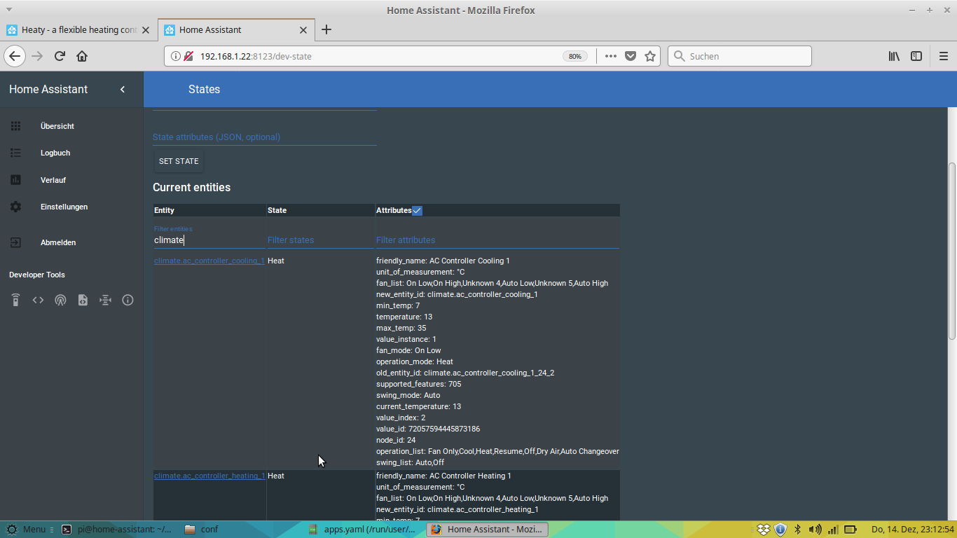

Hey Mate. Got some strage issuue
https://github.com/efficiosoft/hass-heaty/issues/1
I opened a ticket… Ifyou have tinme you might help me with this ?
Thanks for this nice piee of software… waiting my 3 IR climate controllers for my AC

And, by the way, I see that you have added a sensor to the thermostats section. Thermostats have to be setpoint devices using the climate platform… Just wanted to make that clear.
I don’t understand … I have a z wave climate component… What can i put there?
I think you are very familiar with python and might be interested in developing another app? I’d like having the braodlink CLimate custom component for Xiaomi Chuagnir . There is a Switch custom component for the xiaomi ir blaster but no climate component. Would you mind throwing an eye on this? Would be awesome. Like this i could use those for my setup
Probably, your Z-Wave climate component generates multiple entities. Mine do as well. There should be an entity starting with climate. besides the sensor. you used. Just look it up in Home Assistant’s web interface. Best would be to go under Settings -> Customize -> Select the entity that has climate, probably at the end of its name. Then, look up the new_entity_id at the right sight. That’s it.
Maybe one Z-Wave thermostat produces even multiple climate entities. Mine generate three per thermostat. You have to take the one you also use to set the temperature manually via the web interface.
Sorry, but I’ve got none of these. And, at the moment, I’ve got enough work with Heaty
But the community is large and there might be someone having these units at home and wanting to integrate them.
