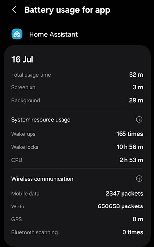

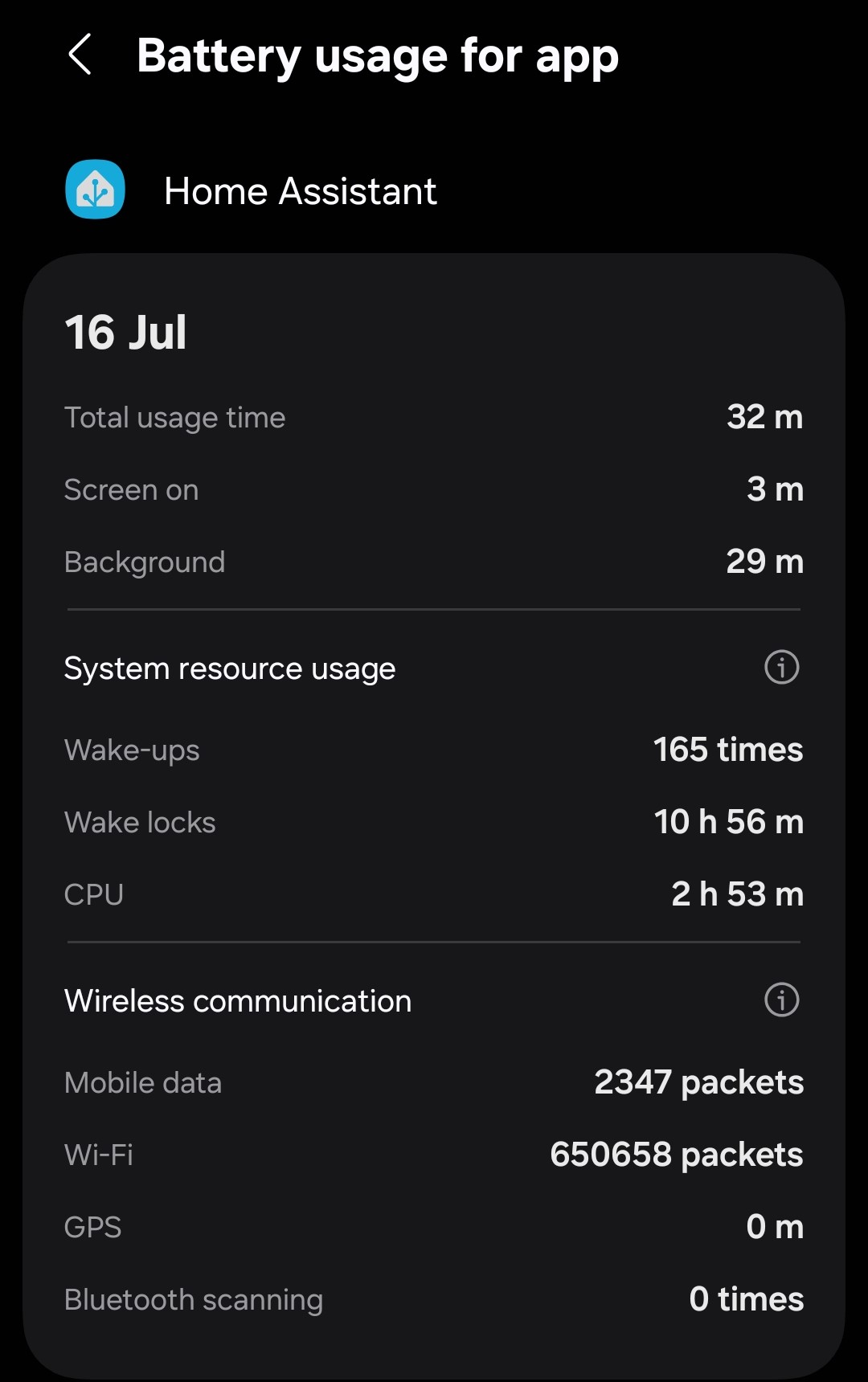

The Home Assistant companion app is by far the most energy demanding app on my phone and I use the phone all day long with all sorts of apps.

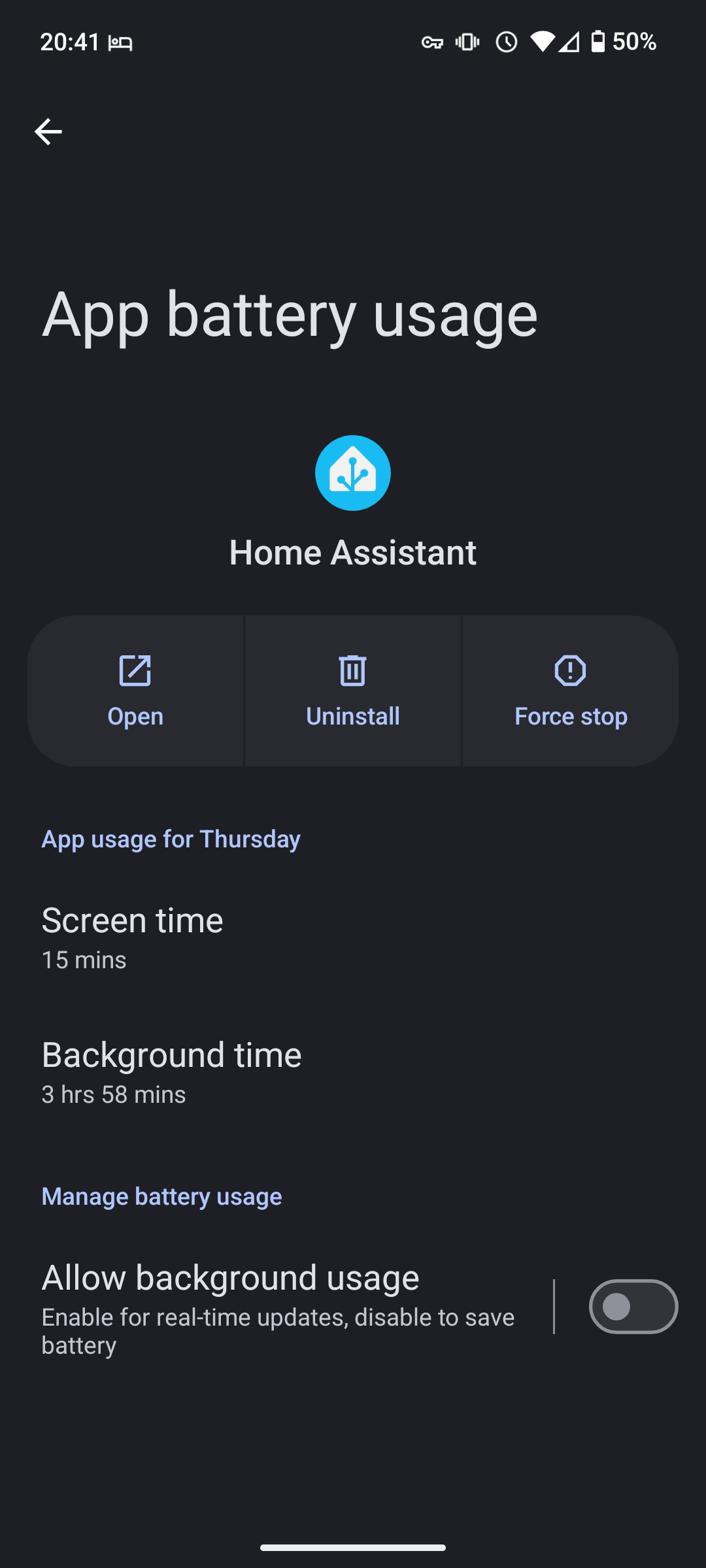

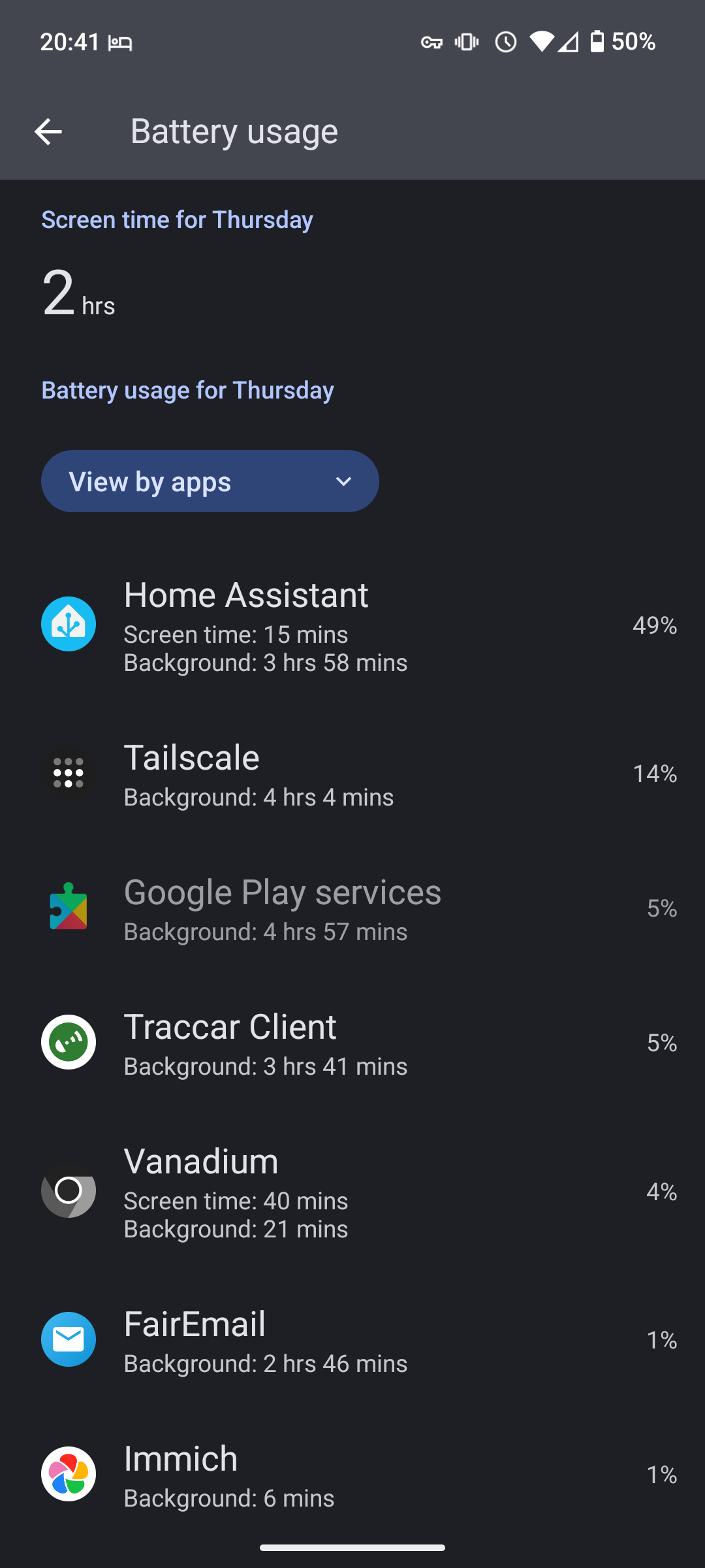

I have quite high battery use but no video on my default view.
Data usage is 245mb /day for the past few days, only 10mb/day in background (if that’s accurate).
I tried turning off background usage, but it didn’t make any difference today.
Actually… My question is moot. All my video feeds are already on a separate dashboard. Any suggestions on pinpointing the usage?
