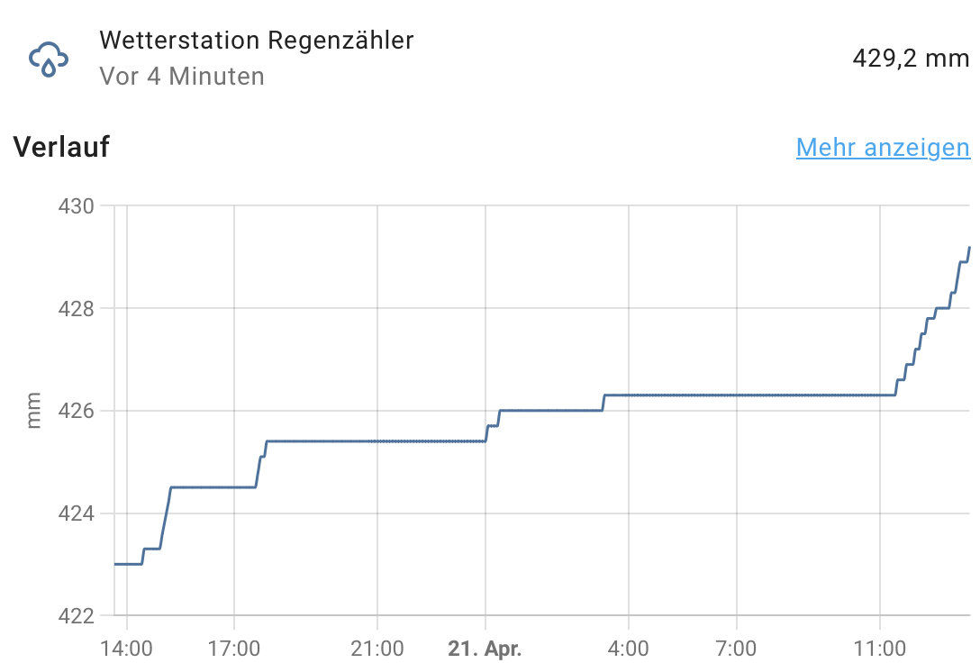

Could you please make a screenshot of the sensor.wetterstation_regenzahler diagram?
Not sure how this sensor behaves. I want to see if the values go back to 0.
For example the period between 17:00 and 21:00 of April 20th would be interesting to be compared. Please add the sensor and the statistic sensor to the same dashboard and make a screenshot of both at the same time to be able to compare the data.

The rain counter sensor.wetterstation_regenzahler is incrementing and will never get smaller values.
I try to creat the view in the next hours. But it want to simulate rain by my self where I now the amount of water flown through the sensor.

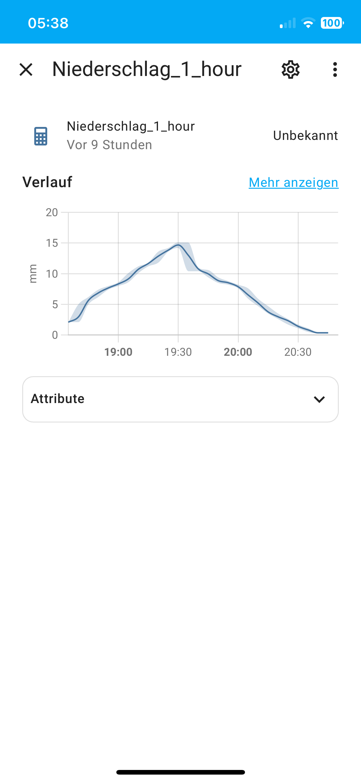

Here you can se the values of last nights rain:
I would like to say thank you to all of you for your ideas an the good support.
