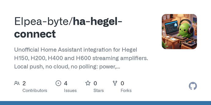

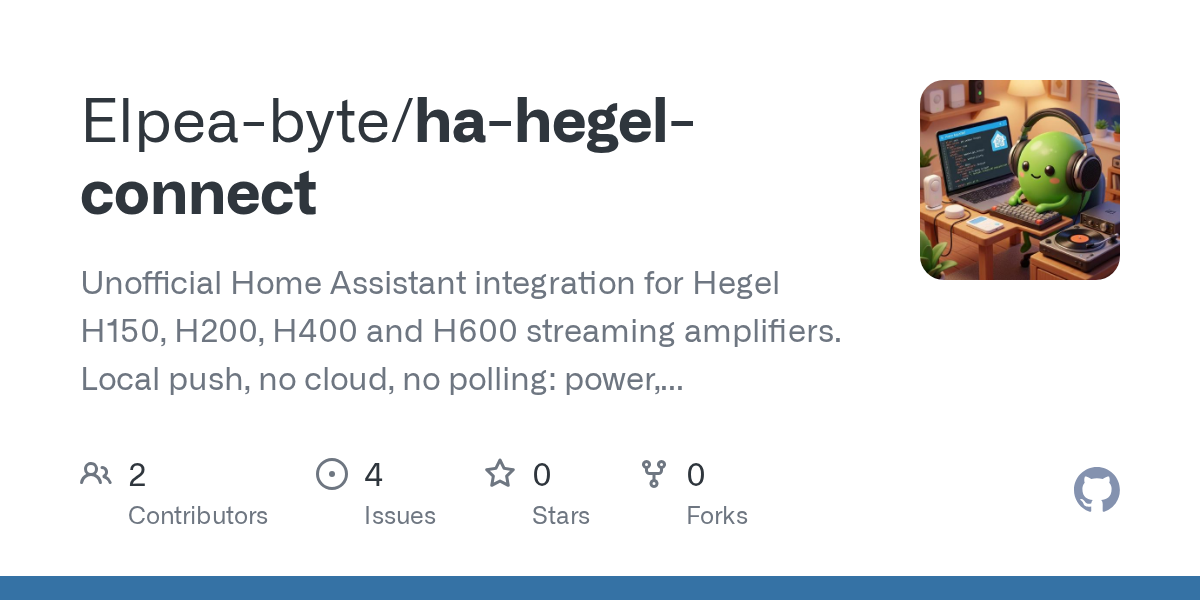

Your workaround gives it away: /api/getData with powermanager:target is the web API of Hegel’s streaming platform (H150, H200, H400, H600). The built-in Hegel integration is made for the older IP-control models (H190V and earlier, port 50001), so the H200 doesn’t answer it properly.
I built a custom integration for the streaming Hegels: Hegel Connect, available through HACS (add it as a custom repository). It uses that same web API with push instead of polling: power, volume, mute, inputs, playback, now playing with cover art and the stream format.
It’s tested daily on my H150. The H200 should work the same way, but you’d be the first to try it. If you do, please report on GitHub (Issues → Model report), whether it works or not.
