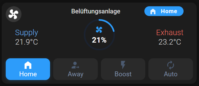

Hi everyone,
Based on this integration, I created a Lovelace UI. It’s my first attempt, so it’s not perfect — but maybe it helps someone as a starting point.
Feel free to improve it or build on it!
Cheers,
Timon
type: custom:mod-card
style: |
  ha-card {
    border-radius: 14px;
   box-shadow: 0 4px 24px 0 #0004;
    padding: 10px;
    border: none;
    background: #1D1D1D;
card:
  type: vertical-stack
  cards:
    - type: custom:button-card
      entity: switch.kwl_on_off_switch
      icon: mdi:fan
      label: Air Conditioner
      show_icon: true
      tap_action:
        action: toggle
      state:
        - value: "on"
          spin: true
          styles:
            card:
              - background: none
            icon:
              - animation: rotating 5s linear infinite
        - value: "off"
          icon: mdi:fan-off
          styles:
            card:
              - background: none
      custom_fields:
        kwlstate: |
            const mode = states['select.select_state_of_the_kwl']?.state || 'Unknown';
            const iconMap = {
              AtHome:      {icon: "mdi:home-variant",      color:"#2d9cfa",  label:"Home"},
              Away:        {icon: "mdi:account-arrow-right",color:"#607d8b", label:"Away"},
              Intensive:   {icon: "mdi:flash",             color:"#fea726",  label:"Boost"},
              Individual:  {icon: "mdi:autorenew",         color:"#7c4dff",  label:"Auto"},
            const meta = iconMap[mode] || {icon:"mdi:help-circle", color:"#757575", label:mode};
            return `
              <span style="
                display:inline-flex;align-items:center;
                gap:9px;background:${meta.color};color:white;
                border-radius:14px;
                padding:3px 16px 3px 12px;
                font-size:15px;font-weight:600;box-shadow:0 1px 4px 0 rgba(0,0,0,0.10);letter-spacing:0.5px;">
                <ha-icon icon="${meta.icon}" style="width:19px;height:19px;margin-right:2px;color:white;opacity:0.87"></ha-icon>
                ${meta.label}
              </span>
        fanspeed: |
            const percent = parseInt(states['sensor.kwl_220_d_l_current_fan_speed']?.state || 0, 10);
            const is_on = states['switch.kwl_on_off_switch']?.state === "on";
            const fan_icon = is_on ? "mdi:fan" : "mdi:fan-off";
            const size = 80;
            const stroke = 4;
            const radius = (size - stroke) / 2;
            const circumference = 2 * Math.PI * radius;
            const offset = circumference * (1 - percent / 100);
            const innerPadding = 10;
            return `
              <style>
                @keyframes spin-fan {
                  0% { transform: rotate(0deg);}
                  100% { transform: rotate(360deg);}
              </style>
              <div style="position:relative;width:${size}px;height:${size}px;display:flex;align-items:center;justify-content:center;">
                <svg width="${size}" height="${size}" style="position:absolute;top:0;left:0;">
                  <circle
                    cx="${size/2}" cy="${size/2}" r="${radius}"
                    stroke="#122E63"
                    stroke-opacity="0.25"
                    stroke-width="${stroke}"
                    fill="none"
                  <circle
                    stroke="#2D9CFA"
                    fill="none"
                    stroke-dasharray="${circumference}"
                    stroke-dashoffset="${offset}"
                    stroke-linecap="round"
                    transform="rotate(-90 ${size/2} ${size/2})"
                </svg>
                <div style="position:relative;display:flex;flex-direction:column;align-items:center;justify-content:center;z-index:1;padding:${innerPadding}px;">
                  <ha-icon icon="${fan_icon}" style="color:#2D9CFA;width:22px;height:22px;${is_on ? 'animation: spin-fan 4s linear infinite;' : ''};margin-bottom:2px;"></ha-icon>
                  <span style="font-size:20px;font-weight:600;color:white;margin-top:2px;">${percent}%</span>
                </div>
              </div>
        icon: ""
        exhaust: |
            return '<div style="color: #FF6F61;">Exhaust</div>' + (states['sensor.kwl_220_d_l_exhaust_temperature']?.state || 'N/A') + '°C';
        supply: |
            return '<div style="color: #6BB9FF;">Supply</div>' + (states['sensor.kwl_220_d_l_supply_temperature']?.state || 'N/A') + '°C';
      styles:
        card:
          - padding: 0px 24px 12px 24px
          - background: none
        grid:
          - grid-template-areas: |
              ".  name      kwlstate"
              "supply fanspeed exhaust"
          - grid-template-columns: 1fr 1fr 1fr
          - grid-template-rows: min-content min-content min-content min-content min-content
        name:
          - grid-area: name
          - justify-self: start
          - font-size: 16px
          - font-weight: 500
          - color: rgba(255, 255, 255, 0.85)
        custom_fields:
          kwlstate:
            - grid-area: kwlstate
            - justify-self: end
            - align-self: start
            - margin-top: 0px
            - margin-right: 0px
          exhaust:
            - grid-area: exhaust
            - font-size: 20px
            - font-weight: 300
            - justify-self: end
            - margin-top: 20px
          supply:
            - grid-area: supply
            - font-size: 20px
            - font-weight: 300
            - margin-top: 20px
          fanspeed:
            - grid-area: fanspeed
            - justify-self: center
            - align-self: center
            - margin-top: 8px
            - margin-bottom: 0px
        img_cell:
          - position: absolute
          - left: 0
          - top: 0px
          - width: 32px
          - height: 32px
          - justify-self: baseline
          - background-color: rgba(55,55,55,1)
          - border-radius: 50%
          - padding: 4px
        icon:
          - grid-area: icon
          - width: 64px
          - color: white
    - type: horizontal-stack
      cards:
          entity: select.select_state_of_the_kwl
          icon: mdi:home-variant
          tap_action:
            action: call-service
            service: select.select_option
              entity_id: select.select_state_of_the_kwl
              option: AtHome
          styles:
            card:
              - border-radius: 12px
              - background-color: |
                    return entity.state === "AtHome" ? "#2d9cfa" : "rgba(255,255,255,0.06)";
              - color: |
                    return entity.state === "AtHome" ? "#fff" : "#7b8ca7";
              - font-weight: 600px
              - box-shadow: |
                    return entity.state === "AtHome" ? "0 2px 8px 0 #2d9cfa30" : "none";
              - min-width: 56px
              - min-height: 46px
              - transition: 0.22s
              - cursor: pointer
            icon:
              - color: |
                    return entity.state === "AtHome" ? "#fff" : "#4b5a70";
              - width: 26px
              - height: 26px
          icon: mdi:account-arrow-right
          tap_action:
              option: Away
          styles:
            card:
                    return entity.state === "Away" ? "#607d8b" : "rgba(255,255,255,0.06)";
              - color: |
                    return entity.state === "Away" ? "#fff" : "#7b8ca7";
              - box-shadow: |
                    return entity.state === "Away" ? "0 2px 8px 0 #607d8b30" : "none";
              - min-width: 56px
              - min-height: 46px
              - transition: 0.22s
              - cursor: pointer
            icon:
              - color: |
                    return entity.state === "Away" ? "#fff" : "#4b5a70";
              - width: 26px
              - height: 26px
          icon: mdi:flash
          tap_action:
              option: Intensive
          styles:
            card:
                    return entity.state === "Intensive" ? "#fea726" : "rgba(255,255,255,0.06)";
              - color: |
                    return entity.state === "Intensive" ? "#fff" : "#7b8ca7";
              - box-shadow: |
                    return entity.state === "Intensive" ? "0 2px 8px 0 #fea72630" : "none";
              - min-width: 56px
              - min-height: 46px
              - transition: 0.22s
              - cursor: pointer
            icon:
              - color: |
                    return entity.state === "Intensive" ? "#fff" : "#4b5a70";
              - width: 26px
              - height: 26px
          icon: mdi:autorenew
          tap_action:
              option: Individual
          styles:
            card:
                    return entity.state === "Individual" ? "#7c4dff" : "rgba(255,255,255,0.06)";
              - color: |
                    return entity.state === "Individual" ? "#fff" : "#7b8ca7";
              - box-shadow: |
                    return entity.state === "Individual" ? "0 2px 8px 0 #7c4dff30" : "none";
              - min-width: 56px
              - min-height: 46px
              - transition: 0.22s
              - cursor: pointer
            icon:
              - color: |
                    return entity.state === "Individual" ? "#fff" : "#4b5a70";
              - width: 26px
              - height: 26px
Looks cool :smiley:

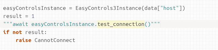

Hi everyone
Oh no, I had it really working and it worked perfectly.
But suddenly it stopped working again. Probably after an update from HA. All entities were inactive so I uninstalled it and tried to install it again.
Now I get the message ‘cannot_connect’ or ‘unknown’ again when I try to install the integration. I had the same problem before, but i can’t remember how I solved it :slight_smile:
If I interpret it correctly, the config script fails at the function: easyControlsInstance.test_connection().
If I replace the response with ‘true’, I can install the integration, but no entities are created.
What else can I try?
EasyControls version: 1.0.23 (previously 1.0.19)

Yes, I had the same errors with 1.0.23 as with 1.0.19.
Since it was working until recently and then stopped, I assume it was an HA update. However, I can’t rule out other causes. But I can’t think of any other changes.
And yes, the KWL web interface is accessible in the browser.
I’m annoyed because I obviously found the solution myself once before, but I can’t remember how :slight_smile:
I have an additional update: As I wrote, I tried to cheat by adjusting the code in config_flow.py as follows.
This skipped the test_connection() function and allowed me to install the integration.
Unfortunately, no entities are created and the following error message appears in the log:
and this
Perhaps this will help. It appears at the time, HA tries to load the integration

I think I have found the error: The config_flow crashed when it was searching for my KWL-type (it’s 40054-003).
I tried adding this number to the array in deviceList.py but this didn’t work.
When i comment out line 76 in EasyControls3Instance.py everything works like a charm. Except device-type is probably “None”.
grafik
Perhaps you could add 40054-003 for others…
Thanks a lot!
