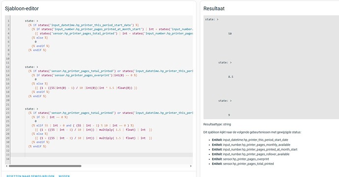

I tried Float but this also does not work

Thanks for the response!
I gave it a try but it still shows 1.0 now.

It’s not working correctly :frowning:
I tried changing the (1 + ((overprint - 1) to 1.5 but now it s counting +2 on every overprint block.
Put the whole template that isn’t giving the desired result (the bit under state:) into Developer Tools / Template and work on it there.
You have a lot of |int filters in your templates, so I’m not surprised it’s rounding. A blanket change to |float might be a good starting point to see if that fixes it, then you can revert the true integers (like page counts).
I replaced all sensors with values, and it seems something is wrong or wrong formatted in the calculation. When i round the multiply to 1 or 2 or 3 it works, but not with .5
Float / int makes no difference, always a wrong result with .5
You do not need most of those ints and floats. 55 is already a number: 55|int does nothing.
The only time you need to use those are to convert entity states, which are always strings, into numbers.
In your third example, both your elif and your else templates end with an int.
Your calculations are still too complex for me to work out what’s going on. Try replacing each entity with a variable name like in my first response above. By putting the appropriate ints and floats at that level, you then don’t need them in the calculations.
