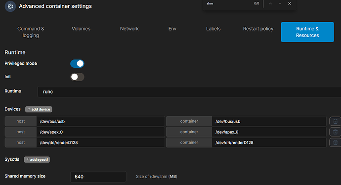

usually it is because the wrong docker file was edited (some people accidentally have multiple), the shm_size value was put in the wrong spot, or user is running in portainer or some other system which overrides the value
Wait… so if I use (also) Portainer to manage my containers I get this weird issue?
I know this is old, but I came across this issue and needed to change my shm with portainer. There is a setting in portainer for the shared memory. It’s under Advanced container settings->Runtime & Resources->Shared memory size. You have to click the Duplicate/edit button to get there and redeploy the container. It worked to change my shm when it didn’t seem to take effect changing the compose file.
