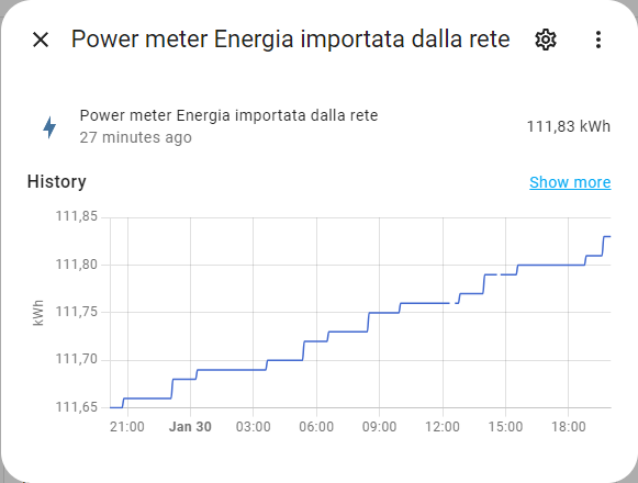

Looking at this plot
If I evaluate 111,83 - 111,68 = 0.15kWh (value at midnight - value now) is equal to what fusionsolar web app say is my consumption from grid
Can I make a sensor to evaluate this value?
Thanks again

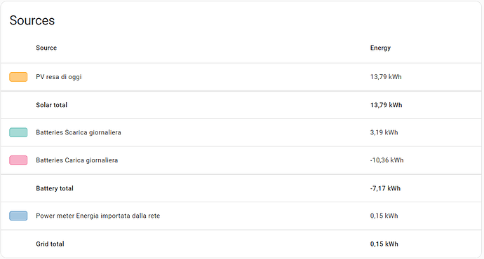

Ok I tried to set the power meter imported by the grid sensor as grid consumption and the plot seems better
and
And
Strange thing in this plot the battery charge/discharge are inverted…

Ok, now the early morning solar production seems fixed
I used the last reply suggestion in this discussion
I changed from daily production to total production in panels setup
The only problem now is the negative production during night (inverter/PV system consumption?)
And I must understand if the battery charging is correct as negative value… I think it should be the opposite (charge positive - discharge negative)

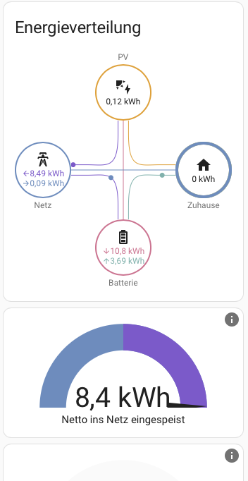

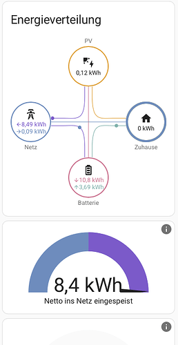

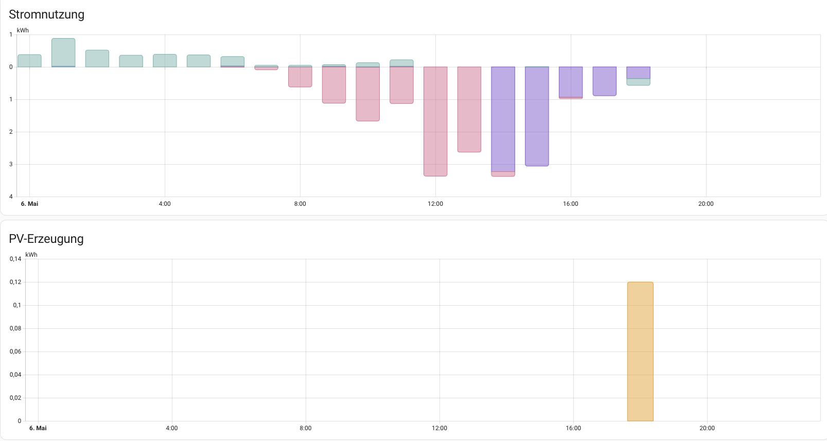

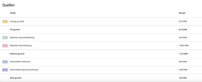

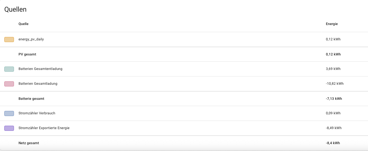

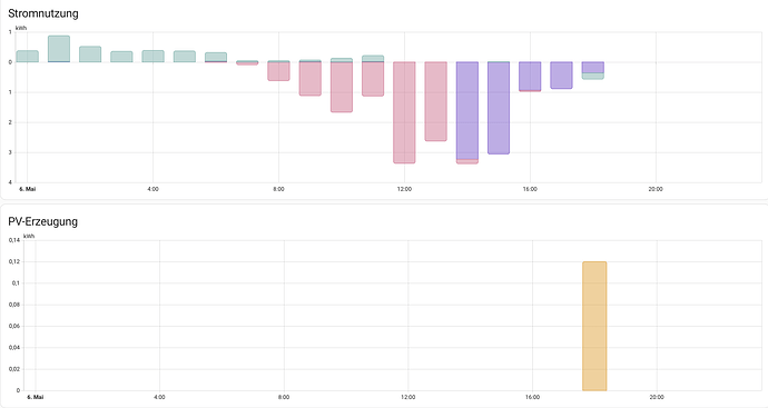

I am at the very beginning of the integration of the Energy dashboard and Huawei Solar and I have similar results as Pietro had in his early stages. What I did is to define the template sensors “energy_pv_daily” and “energy_pv”. The first sensor I’m using as input for PV-Production in the Energy Dashboard. For battery I use sensor.batterien_gesamtladung resp sensor.batterien_gesamtentladung. And for from/to grid the sensors are sensor.stromzahler_verbrauch (consumption) resp sensor.stromzahler_exportierte_energie. Unfortunately my Dashboard looks rather awful and makes no sense to me. Although I have to admit, pv_energ_daily corresponds to FusionSolar-Value as indicated by Pietro. Nevertheless, I am 100% sure my power consumption is higher than zero. Can you please tell me what I’m doing wrong?

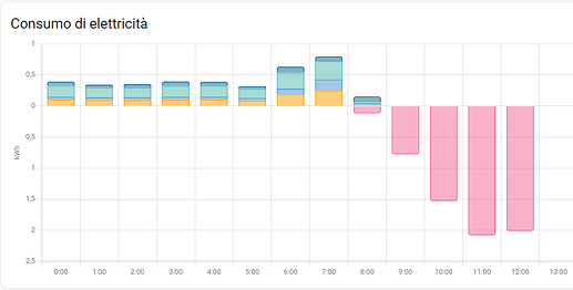

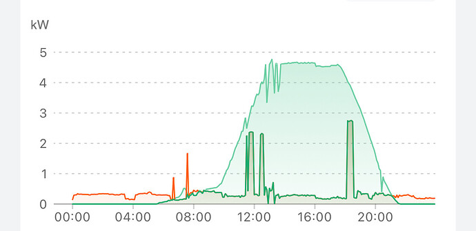

Is it possible to create the following Huawei chart for a dashboard?
