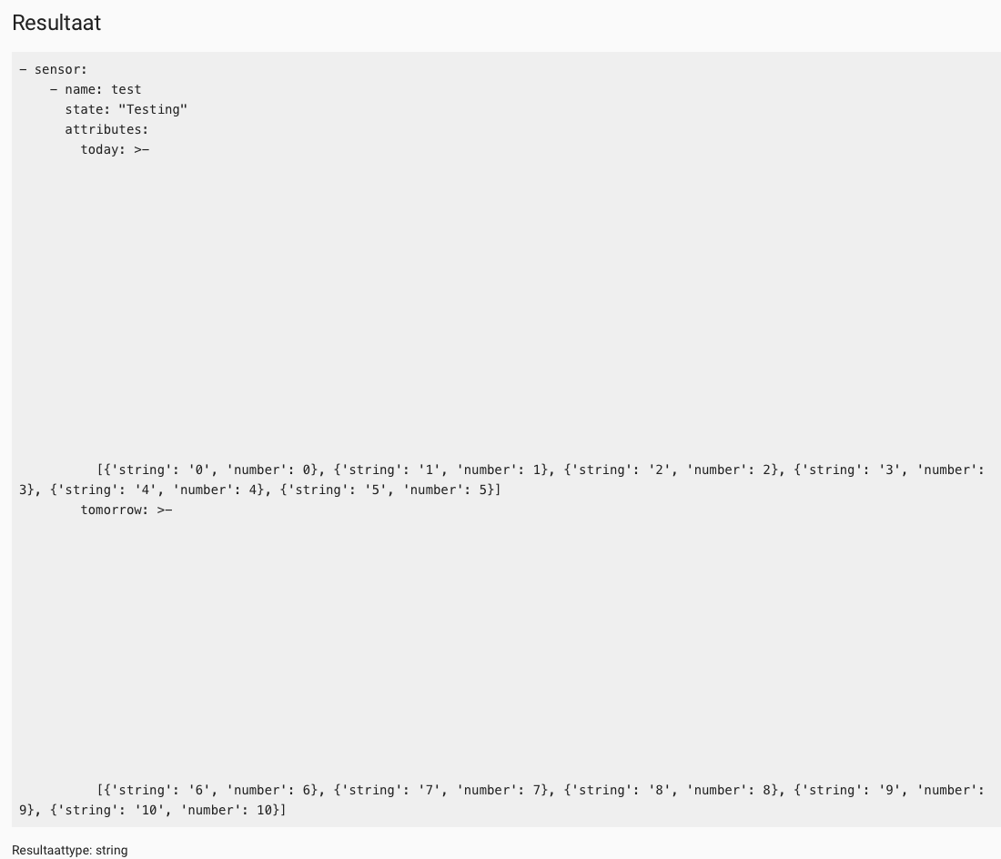

Unfortunately not
Can you post the complete adjusted template sensor code please? I can’t recreate your issue nor see a problem in what you’ve posted.
My test:
- sensor:
    - name: test
      state: "Testing"
      attributes:
        today: >-
          {% set r = range(6) %}
          {% set ns = namespace(output=[]) %}
          {% for i in r %}
            {% set ns.output = ns.output + [{'string': i|string, 'number': i}] %}
          {% endfor %}
          {{ ns.output }}
        tomorrow: >-
          {% set r = range(6,11) %}
          {% for i in r %}
          {% endfor %}
          {{ ns.output }}
Result:

I think there somehow might be something wrong with the template engine.
The template editor always display Result type: String, no matter what template I put in there.
As a test, I made a new VM with a plain HA install and only added only the needed integrations, helpers and the template sensor. Looks correct there:
My HA has grown huge since 2018, too bad if I’ll end up having to more or less start from scratch :confounded:
Found it!
configuration.yaml:
homeassistant:
  #this bugger was the mother of all my problems..:
  legacy_templates: true
Was in the (slow) process of setting up 5 years of work from scratch on a new VM, and added part by part testing every small change. Just saved myself a sh*tload of work :sweat_smile:
“List” it is :+1:
Well done! I didn’t even know about that setting…
Hi, I know this is an old topic. But I’m actually having the exact some problem as described. I can’t get the output in the desired format.
When running the testscript as described by @Troon this is my result
Have you checked if you have a “legacy_template” setting in your configuration.yaml? (See a couple of posts up).
