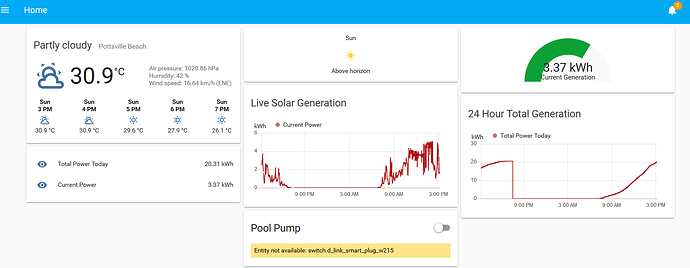

Perhaps if you have used a Lovelace card, you might share the yaml code you used, I like the way you have chosen to show the data…
I am still learning a lot too, below are the 3 relevant cards from my front end.
Does the data show up in the developer-tools states section?
You can use this to see if your actually getting the correct data for each entity to start with.
    entity: sensor.current_power
    max: 5
    min: 0
    name: Current Generation
    severity:
      green: 3
      red: 1
      yellow: 2
    theme: default
    type: gauge
    entities:
      - sensor.current_power
    title: Live Solar Generation
    type: history-graph
    entities:
      - entity: sensor.total_power_today
      - entity: sensor.current_power
      - entity: sensor.power_consumption
    title: ''
    type: entities
