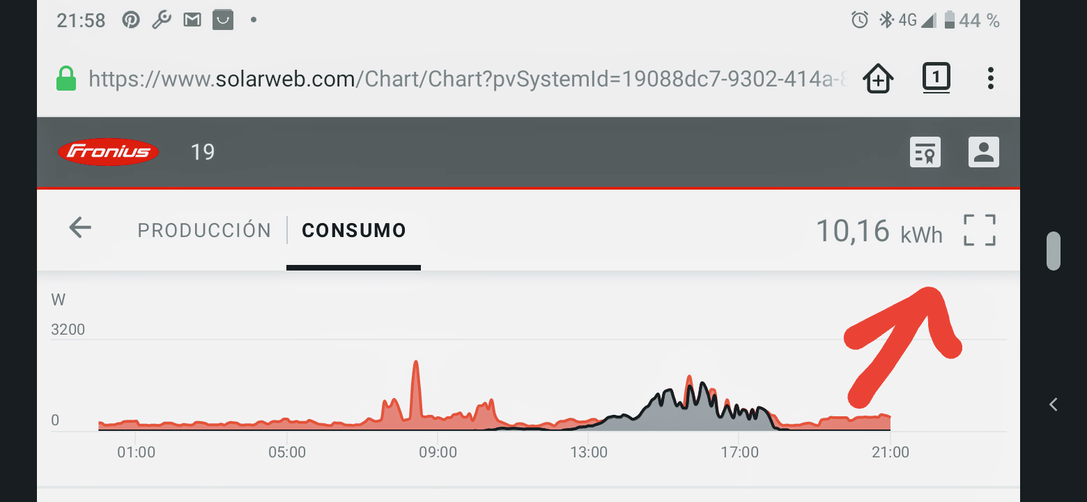

Dear Riccardo thanks por all that work. The total daily energy of the house (solar plus from the grid) its a relevant staff. Could you help me to get the total energy comsuption of the instalation. This number is at the web of Fronius but I can find where is the source.
Thanks and congratulation por your activity.
The total_energy sensor should give you what you want I believe.
Total energy is the total energy produced for the Fronius from the day of instalation. I want watch the total energy of the house each day (from grid and from Fronius) and I can not find the correct sensor. However the Solarweb.com yes it shows this value.
You want total daily consumed or total daily generated ?
