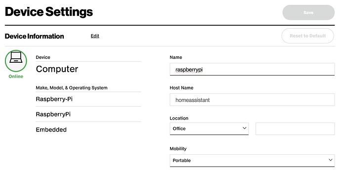

Here is a screenshot of my router:
And here is more info from this Raspberry device connected to my router:

Other thoughts? I’m really perplexed
Probably not the issue, but… Maybe?
I don’t see a default gateway listed in the output you provided…
Just looked at my router. It says the IPv4 Default Gateway is 98.118.xxx.x. However, I access my router with 192.168.1.1
That 98.-adress is your WAN adress. There was a similar thread about this, think he solved it by re-installing HA .
That did it! Reinstalled HA and it fired right up! Wow - you guys are great. Thanks so much for helping me figure this out!
