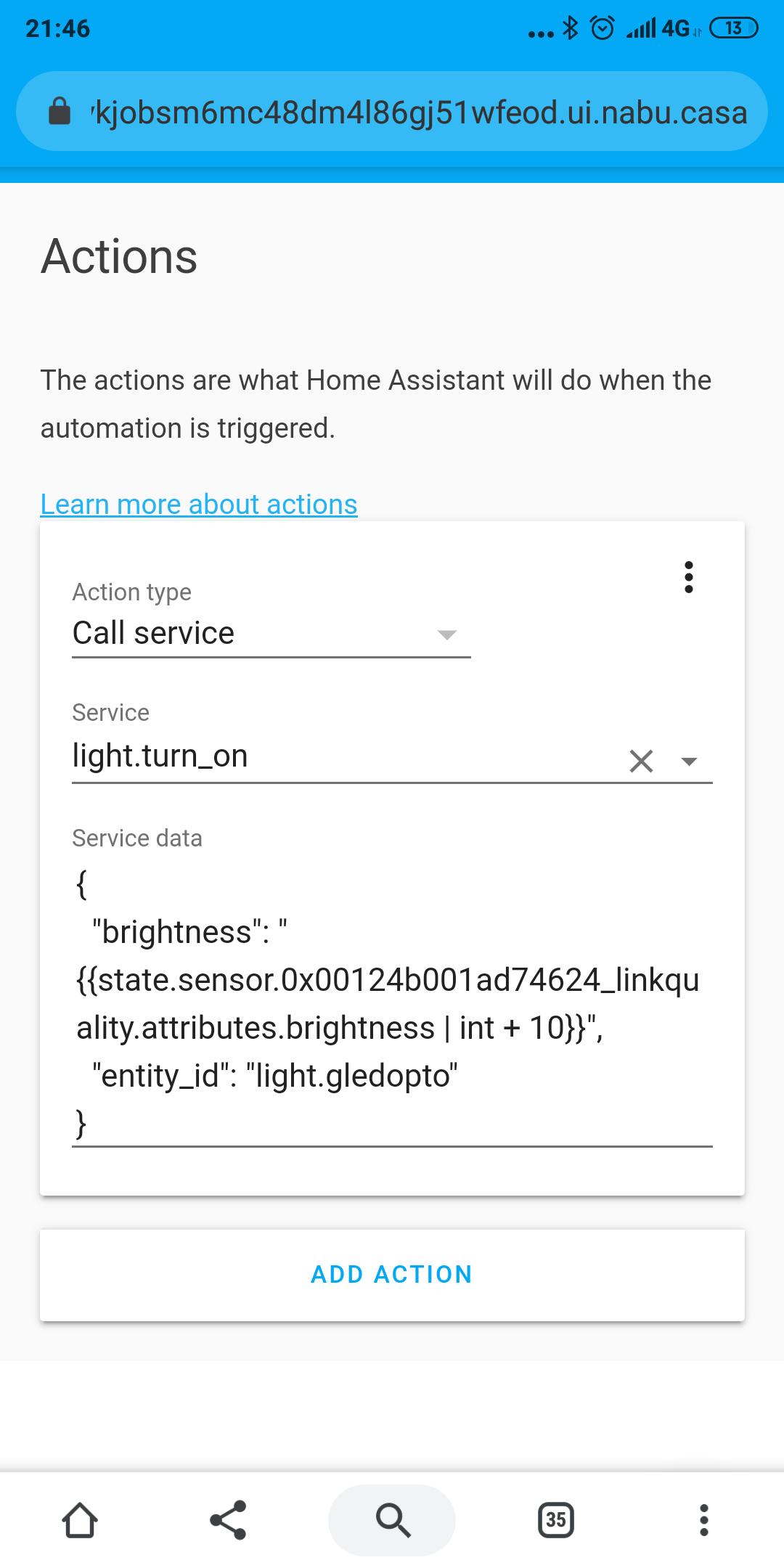

After noticing this i try to adapt my script accordingly, but without success, tried also directly in to yaml, but it seems to not make any difference.
This is how my action section is looking right now:
But it still dont make any change to my light when i trigger it. Any help would be highly appreciated.
