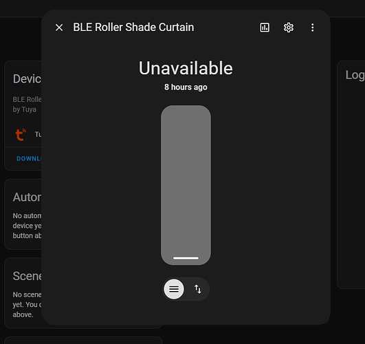

I added it to Smart Life, and the device appeared in Home Assistant. Unfortunately, it is displayed as not available.
I tried adding the device with ‘Local Tuya’ or ‘Tuya BLE,’ but it is not compatible with the curtain.
I attempted to pair the curtain with the Bluetooth of Home Assistant, but it is not detected for addition.
I should mention that the Bluetooth is functional because I use it for other devices.

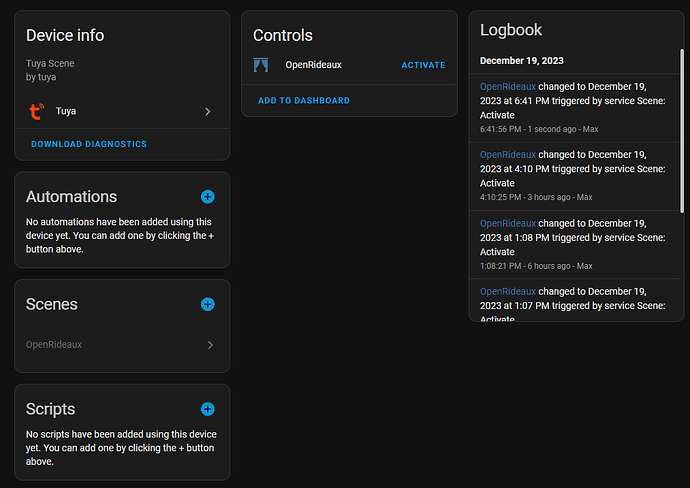

I tried to create a scene in Smart Life to make it available in HA, but when I activate it from HA, nothing happens, even though the call is successful.
2023-12-19 22:05:48.822 DEBUG (SyncWorker_20) [tuya_iot] Request: method = POST, url = https://openapi.tuyaus.com/v1.0/homes/28019536/scenes/<hidden>/trigger, params = None, body = None, t = <hidden>
2023-12-19 22:05:49.187 DEBUG (SyncWorker_20) [tuya_iot] Response: {
  "result": true,
  "success": true,
  "t": <hidden>,
  "tid": "<hidden>"
The traffic is not blocked in my firewall.
For example, here’s a scene created in Smart Life. It shows as usable, but when I activate it, nothing happens.
