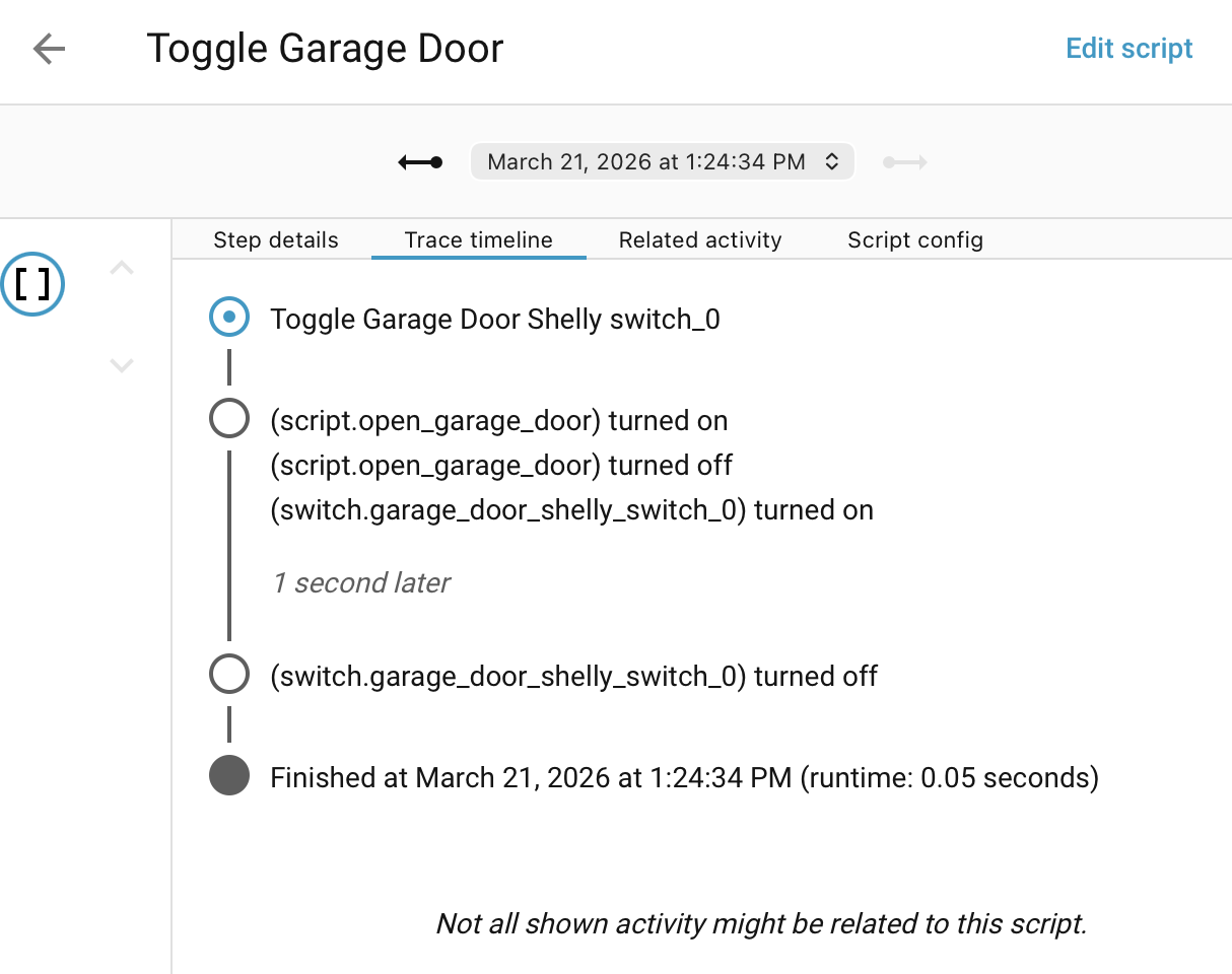

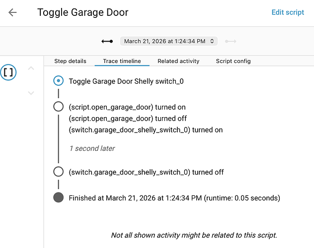

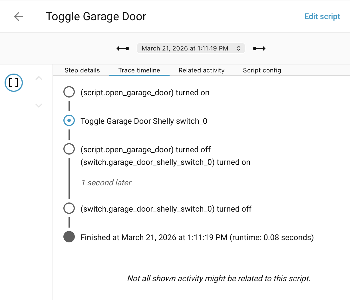

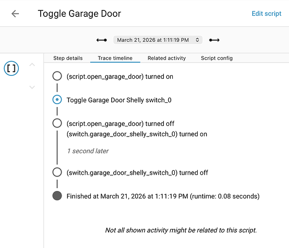

The “Trace timelines” from the Toggle Garage Door script shows slightly different sequences as soon below:
First trace at 1:11:19pm
Second trace of the delayed garage door opening “by itself”
**QUESTIONS:✱
  1. Where is the “script.open_garage_door” shown above? It’s not in my Scripts list, so I’m confused what that even is.
  2. Should I be doing something to flush a queue somewhere in case this happens in the future? Presumably there was an issue somewhere between my watch and my phone, or between the phone and the HA server that caused the delay. However, it’s very interesting that the first trace is different than the second trace, so I think it gives clue as to what’s going on. However, I don’t have a good understanding of how the HA system queues different requests, so I’m feeling a little stuck.

this could be the entity id of your script, check its id.
I do not know the exact solution, I am assuming that this is related to apple watch/network etc.
I suggest that, you can check if you are at home inside your script before executing shelly command.
You’re exactly right. Thanks for clarify up the name confusion. And I love your suggestion regarding checking the location before issuing the actual command. Thanks for taking the time to consider all this!
