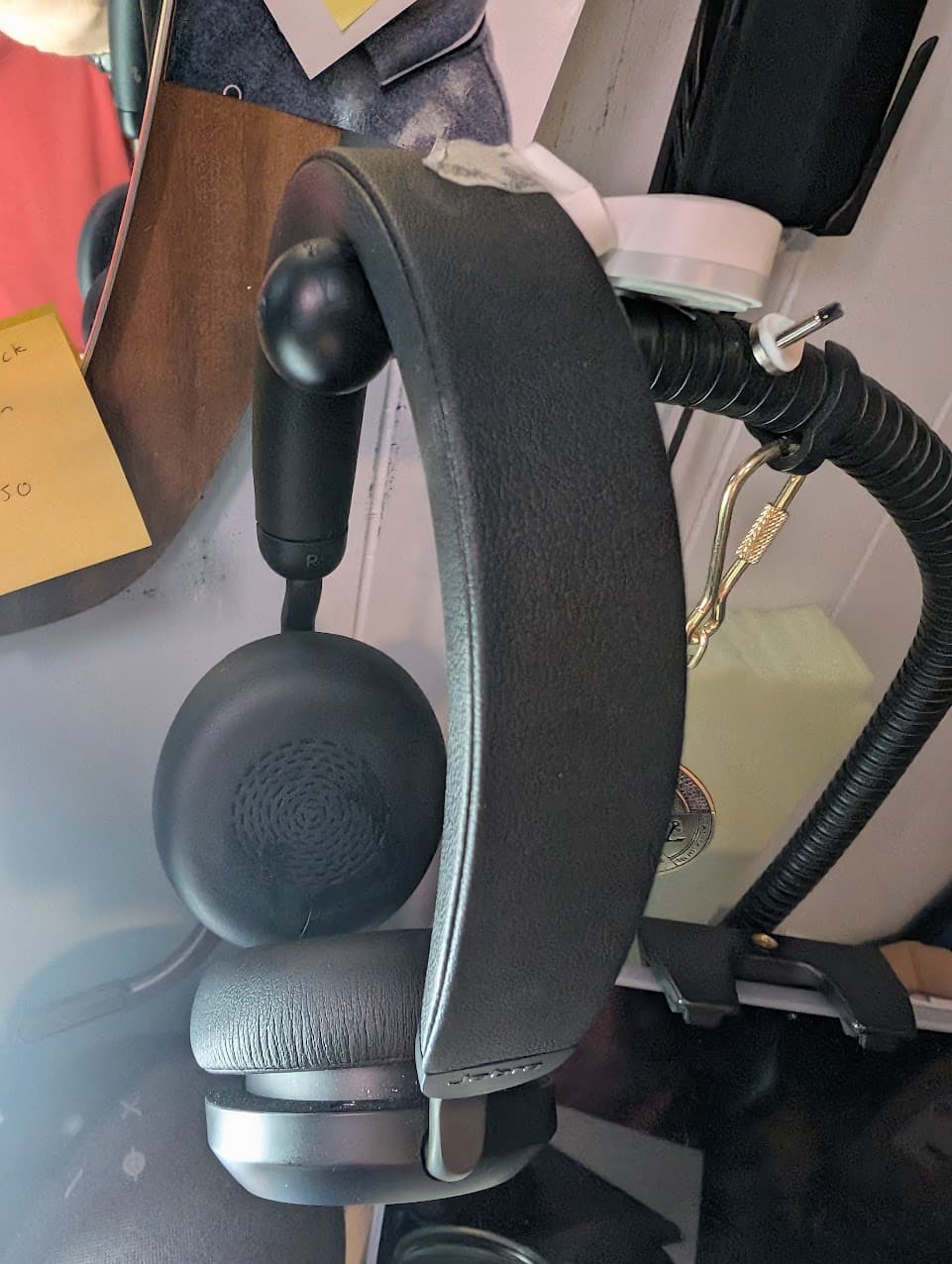

I was thinking weight sensor or some kind of crappy webcam looking for a white spot I’d paint on top of the headset stand which would be covered up by the headset when it’s on the stand.

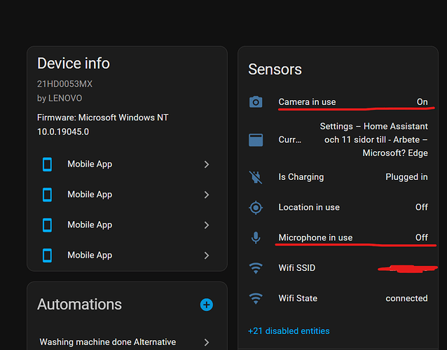

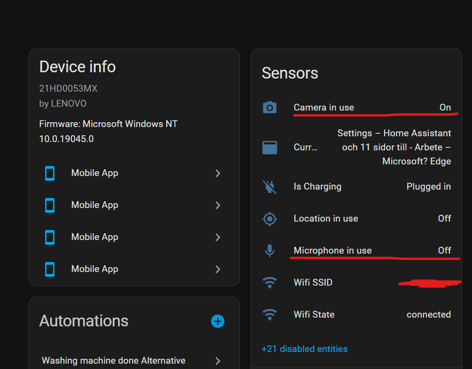

I have sensors from my work pc that I can use to determine if I’m in a meeting.
That’s an ok solution however, it doesn’t allow for phone calls and watching of training videos etc. I need something that just detects if the headset is on the stand or not on the stand.

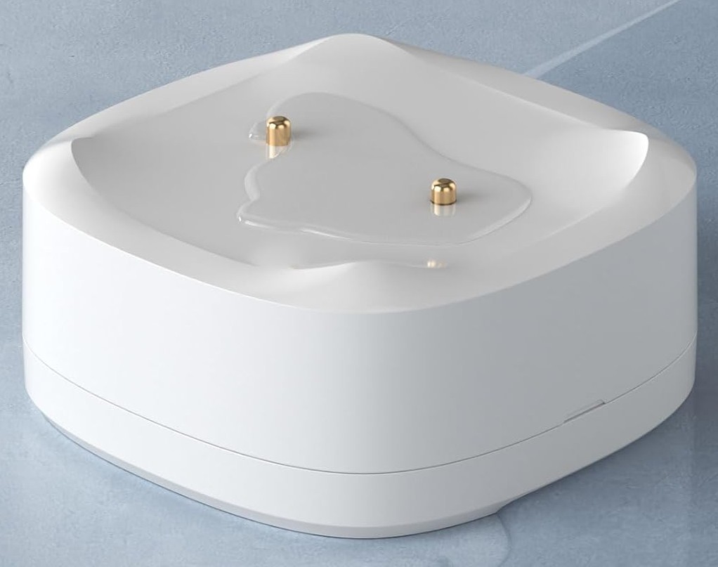

If I use a Zigbee leak sensor and attach it to the top of the sand with tape or a glue gun:

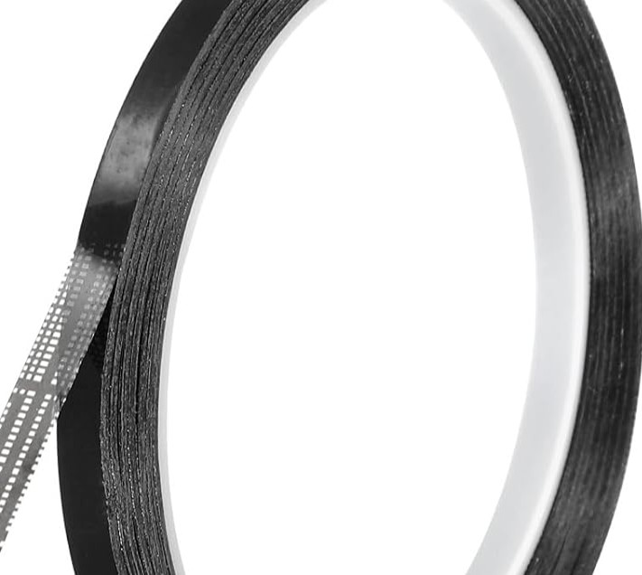

Then add a strip of black conductive tape to the underside of the headset headband
When the headset is resting on the leak sensor It should bridge the dry/wet contacts and register a leak i.e. the headset is on the stand.
When the headset is not on the stand / leak sensor, the black conductive tape should be almost invisible to people in the office when I take my headset with me.
I’ve ordered the materials and will update with photos when finished. I might need to also use the glue gun to build up layers on the leak sensor to guide the headset into the middle of the contacts.
