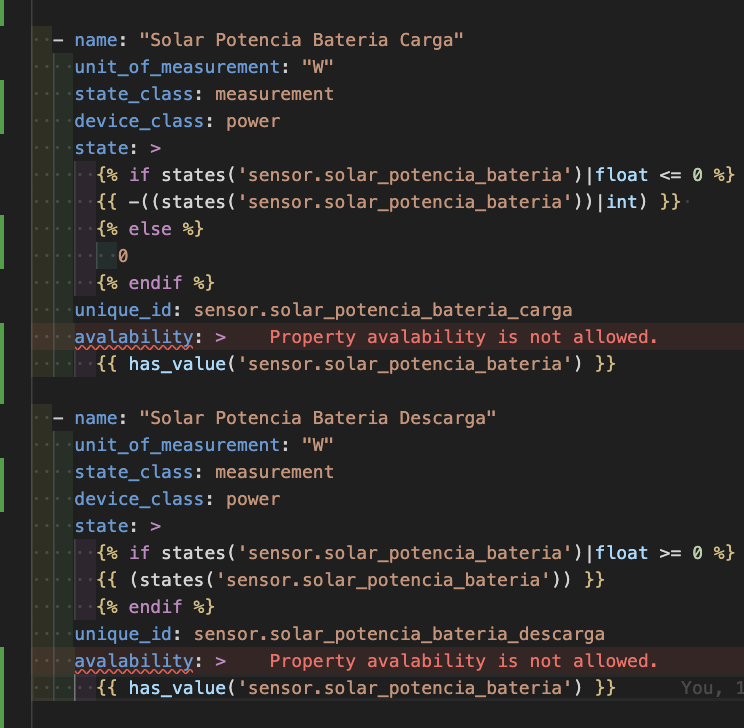

My editor complains about some of the availability entries:
Because apparently I can’t spell “availability”.
Ah! I didn’t noticed it either :joy:
There are still issues with the templates in that screenshot. You must supply an else case for your if statements.
Yes, yes, I added it to all of them, thanks

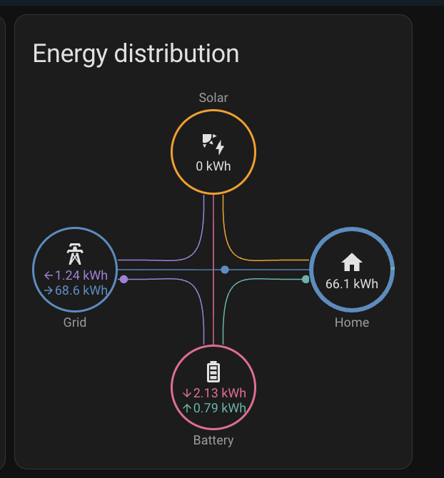

I forgot you have to go to the energy tab and configure them. I expected them to appear automatically. Then I clicked the edit button and it was like an epiphany.
I have now the energy flowing and looking cool:

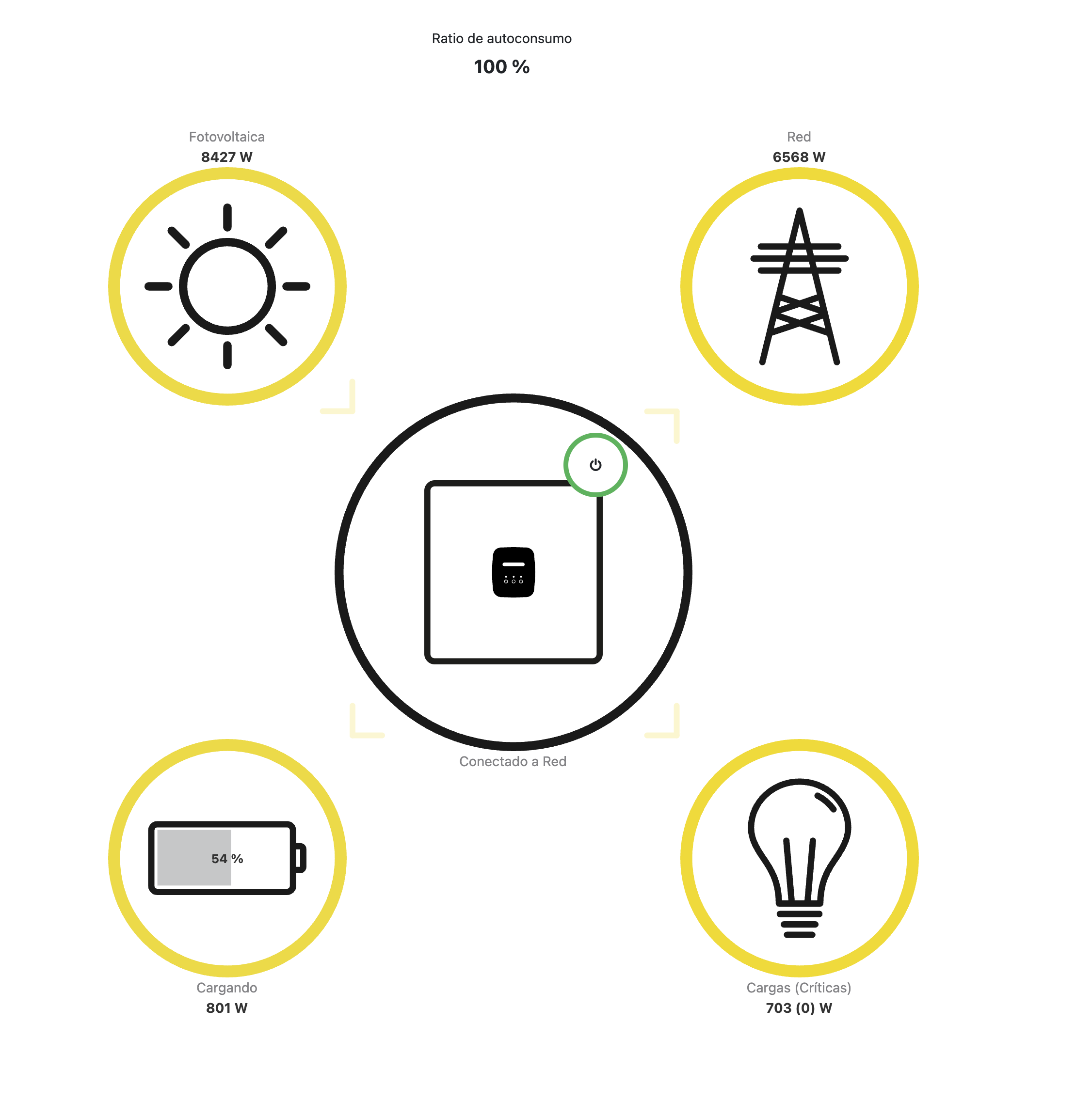

However, there must be some bug with my modbus sensors, because it says my solar production is 0, and that is simply not true:
which ones are those? Post all configs for them
The templates, the modbus and the energy sensors are all thar I have, already posted. You can have a look at the GitHub repository I posted to see the complete thing except for the fixes that has been suggested in this thread. The screenshot at the bottom is from my inversor status page
Yes but which ones, I can’t read Spanish. Or is it just all of them?
Do you mean in the screenshot or in the config?
