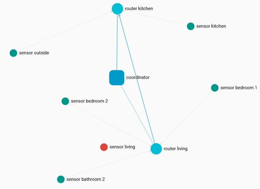

Thank you @tom_l , after a good old reboot of the VM, now this is the ZHA visualization:
Now I have one more question: why is the blue line between coordinator and router living (living room router) dotted? What does it mean?
