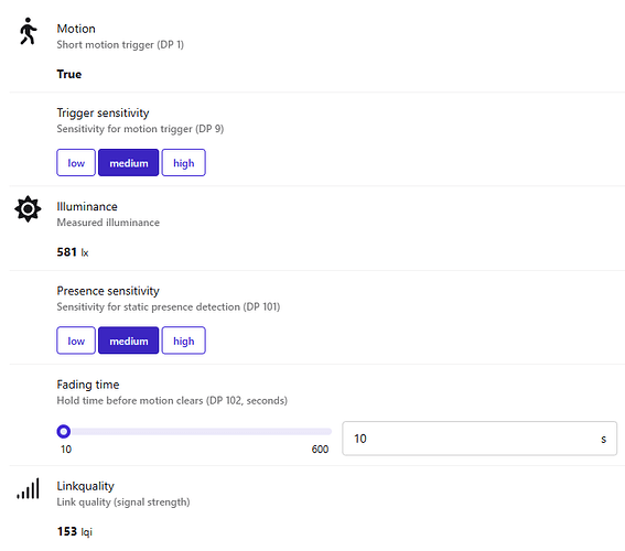

Yes, that's right, if you look at the support and connect the sensor without an external converter, then it is detected with native support. But the problem is that it doesn't work. It only shows the illumination parameters and that's it. The code also specifies the distance parameters, sensitivity, and other parameters, but they are not present in this sensor.
the screenshot is already with my slightly redesigned converter. But it has a problem, Fade Time is not regulated, or rather it does not work correctly. Exactly if you set the value to 10 seconds, it will work at 19 seconds.
