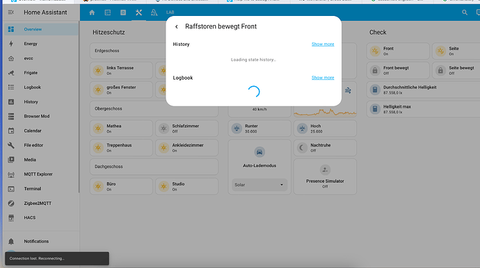

I don’t know what happened but my HAOS is sometime not available anymore (Connection lost. Reconnecting…). When I reboot the VM it’s running smoothly again but after some time I am facing the same issue. First I thought it is a thermal issue and installed a fan but it doesn’t make any difference and all other VMs are running smoothly (Temp is ok). Then I shut down some Add ons but still same issue. Really weird is that HAOS was running fine one week ago. So really don’t know how I can narrow down the issue.
Any ideas?

At the moment I am not able to get on the GUI :frowning:

Don’t know what happen but after the reboot HAOS is up and running but when I go to Settings → System → Logs I am losing the connection again…

By the way, GUI is still not responding but ssh is working.
