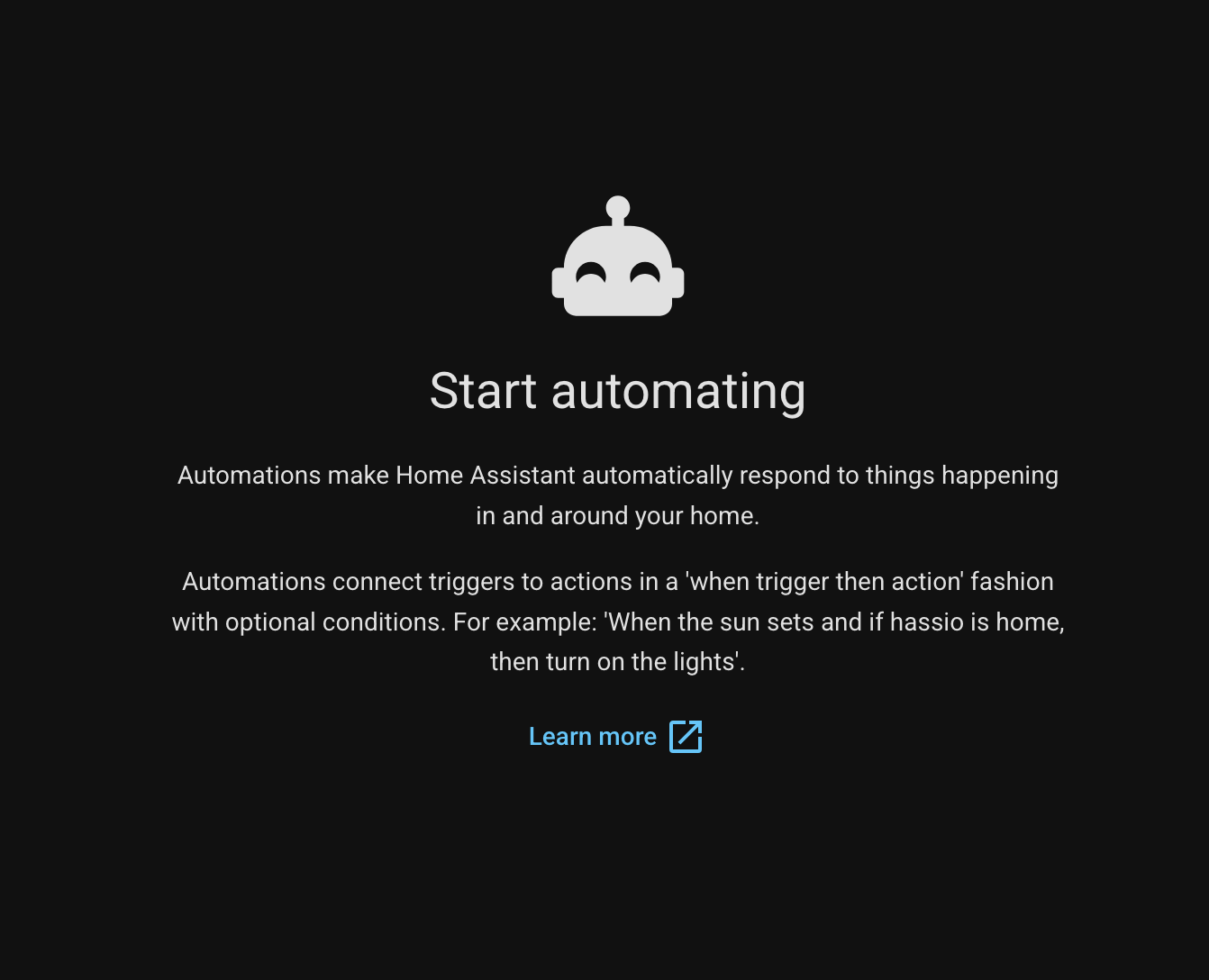

Help! My Automations and Scripts have gone! :C
Hi, I recently added some custom entity images in my config file using (primarily) Home Assistant Core Integration - Home Assistant and Home Assistant Core Integration - Home Assistant
The problem is that after a reboot, my automations and scripts are gone!

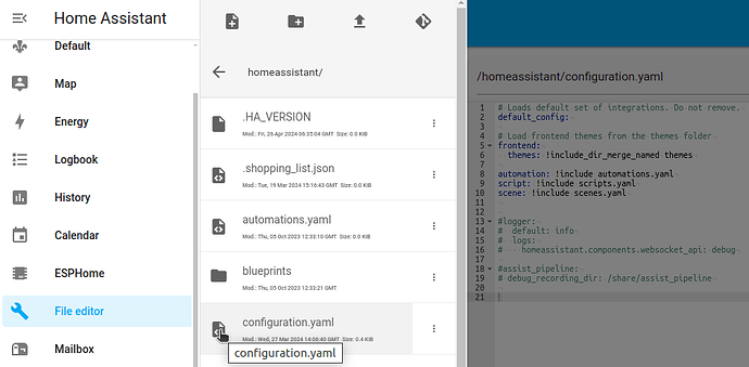

Automation, script and scene should not be indented.
Mine are all the way to the left.
It seems as of you have indented stuff, not only the above, that shouldn’t be indented
“Automation, script and scene should not be indented.”
I tried this, I noticed it in the config image.
But when I do, the dev tools (and the file editor) tell me HA won’t start if its like that :frowning:
Also, I’m pretty sure they were always tabbed in. I didn’t change that.
I’m wondering if adding homeassistant: to the config (now removed) has upset something?
The image shows clearly that it should not be indented.
So just remove the indents.

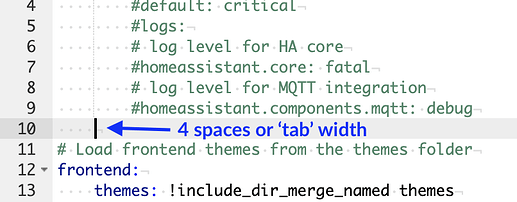

Second line is indented four spaces.
Next is seven, and the last one 12.
Interesting, I just found that sometimes you have to tab, then space, is that normal?
I thought it was ‘just’ tabs. I’m sure I saw it written somewhere that you shouldn’t use spaces in yaml?

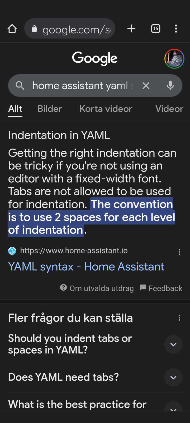

Never use tabs. They are not valid in YAML. Look in your log file and you will likely see found illegal character 't' errors.
Only use spaces.
Some editors can be set up to convert tabs to spaces automatically, but you should get out of the habit of using them.
