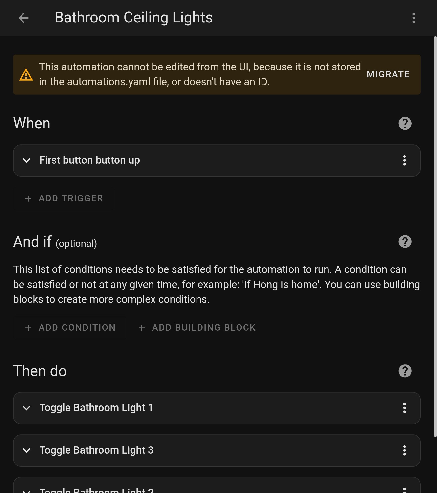

This morning I woke up to most of my lights not working, because the automations I had for my detached shelly relays all show the same error.
Tried pressing Migrate but when I hit save I get Error Response 500.
Was working prior to going to sleep.
Tried to restore from backup and getting another error :sob:
