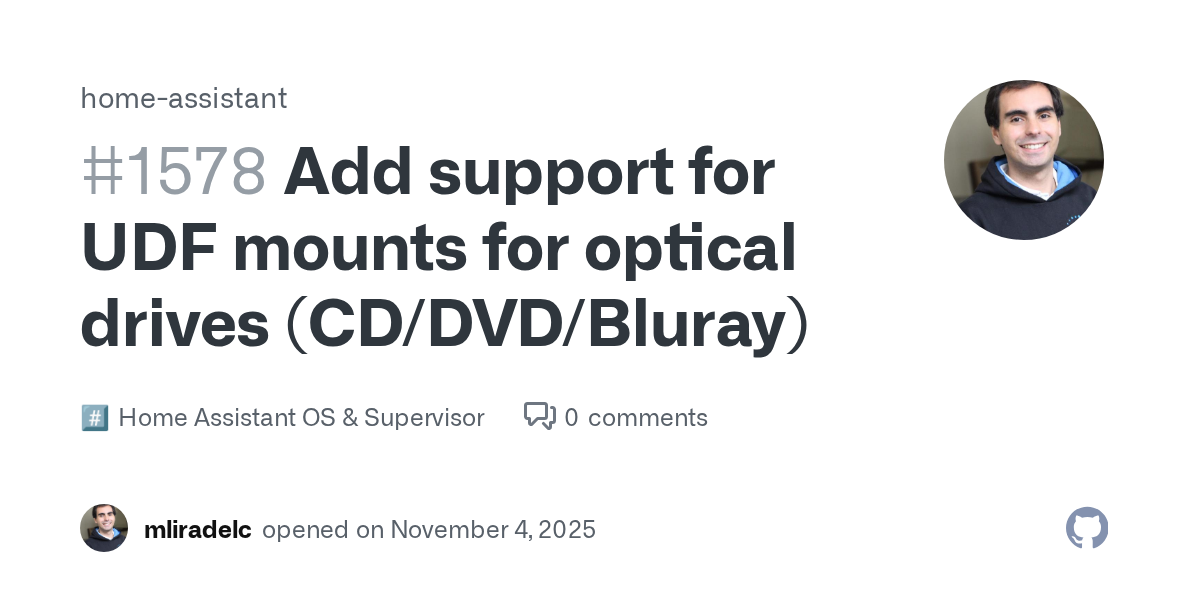

After looking more into the issues I think I hit a Wall. HAOS doesn’t have UDF support. So you can’t mount CDs and DVDs.
To make it work, I would need to compile my own HAOS images, and I don’t have the time or resources to do that.
I would continue if the HAOS devs allow an easy way to add these type of support.
I would kindly ask anyone for their support; please upvote at the HAOS GitHub community to add UDF support.
