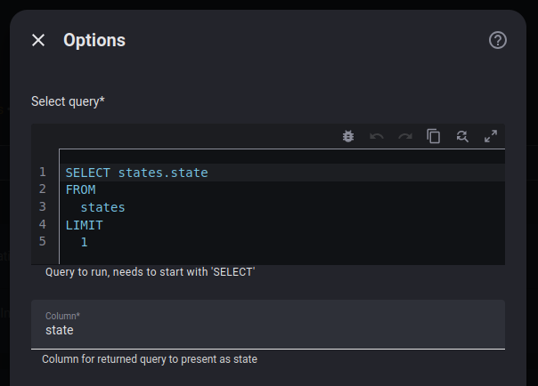

  • 2026-05-28: The sql.query action is, apparently, only available if you have at least one SQL sensor already configured. If you do not currently have a need for a SQL sensor, the following is the simplest query to initiate the integration:
SELECT states.state
FROM
  states
LIMIT
  1
Screenshot of query in the SQL integration's UI config flow
