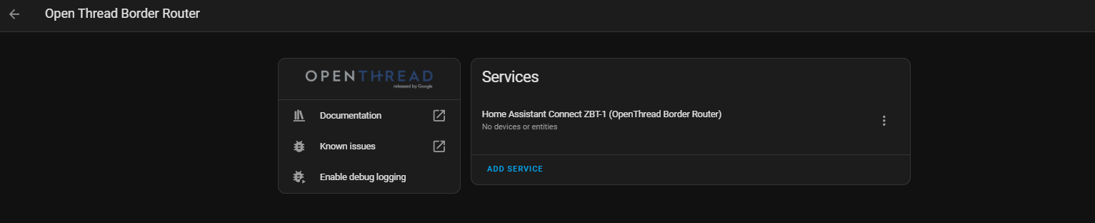

And then there is the thread part of HA… i have Thread and Open Thread Border Router? So which one connects to the Matter part? i’m kind of confused… in the Open Tread border router it says that it’s connected to the Connect ZBT-1 but no devices. and when i click configure in Thread it says it is connected to the open thread border router but it also sees the Tado Border Router?

Thanks for your reply. apparantly all my Tado thermostats are connected to the Tado Bridge in Home Assistant. I unplugged the ZBT-1 and everything is still connected. All this time i thought i used the ZBT-1 haha. would there be any down or upside to using the Tado Bridge or the ZBT-1?
