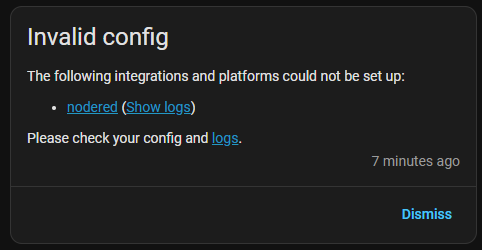

The other day I did a bunch of updates like the newest core etc.
After the restart, I was greeted with an error:

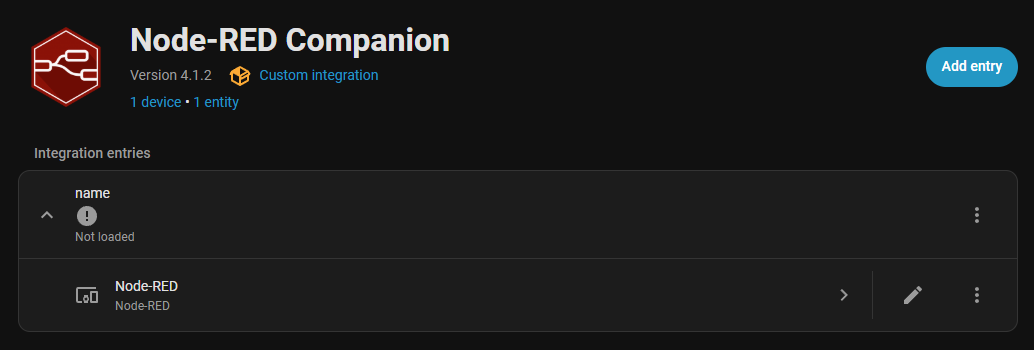

Turns out it is not NodeRed itself, but the companion Integration that fails. Thats what the Integration looks like:
And since then basically my whole home went stupid - including water pressure, heating and warm water, that all rely on NodeRed automations (NodeRed itself works fine), that in turn rely on the sensor data provided by the companion integration. I can switch everything manually, but the family-approval factor of HA has taken a really bad hit over the last 48 hours and the pressure for me to find a solution is rising…
