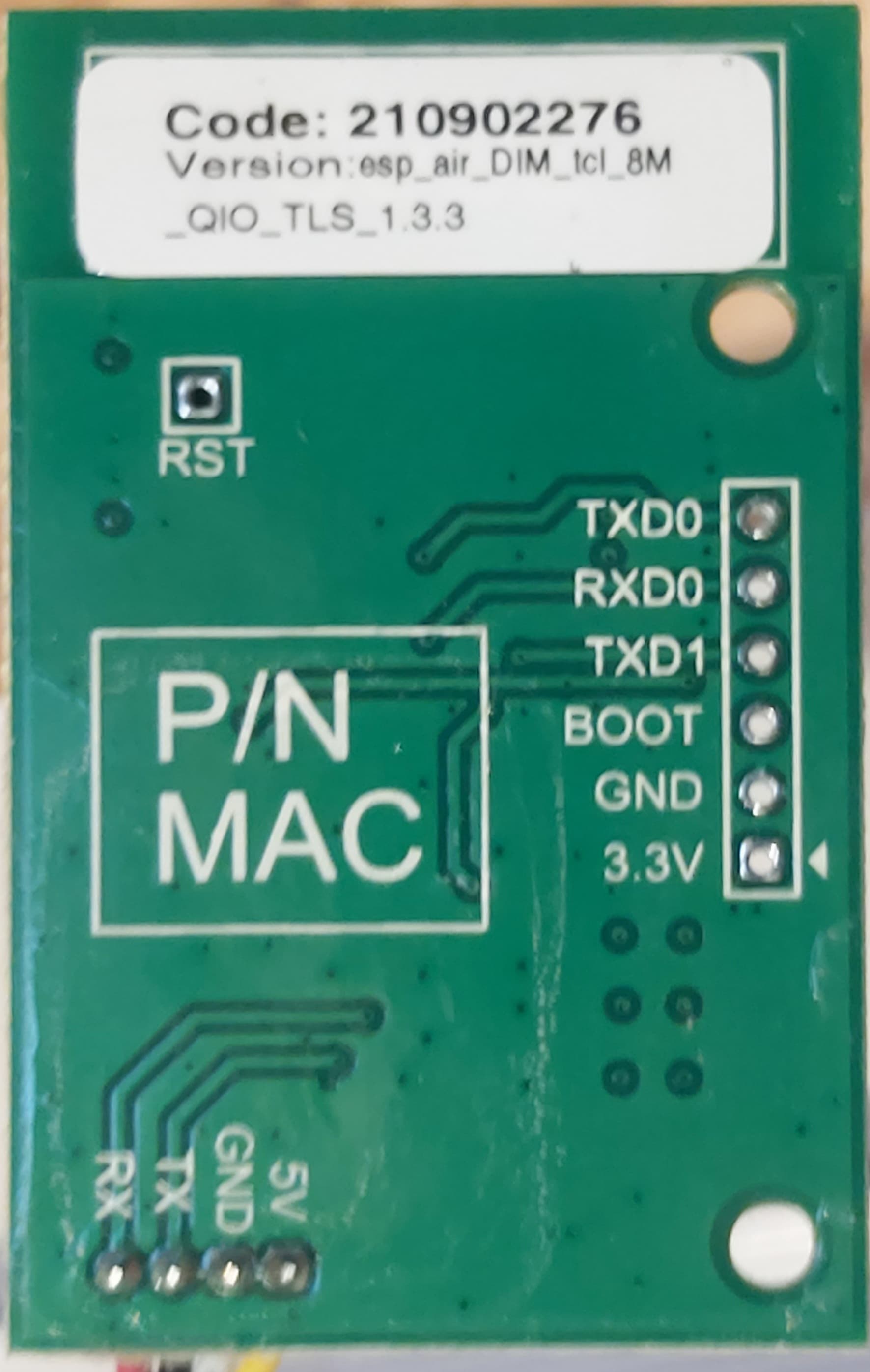

Would also have some more Information about how to flash it and if it is still reliable after all the time :blush:
Here is a picture from the module esp_air_DIM_tcl_8M_QIO_TLS_1.3.3
You need to remove the cable from the ac PCB because you have to power up the wifi module externaly for the flashing process.
Then I have soldered a pin header and connected a flash module like this
Then you have to connect boot pin with gnd on powering up to enable the flashing mode.
You can use the esptool flash_id command to check if the connection was successful.
If it’s working, you can use esphome flashing web tool to flash esphome
Esphome is still running since 6 months on my device
Thank you @KG3RK3N ! :blush:
Could you please re-upload the Image? I got an access denied…
This link shouldn’t expire now esp_air_DIM_tcl_8M_QIO_TLS_1.3.3

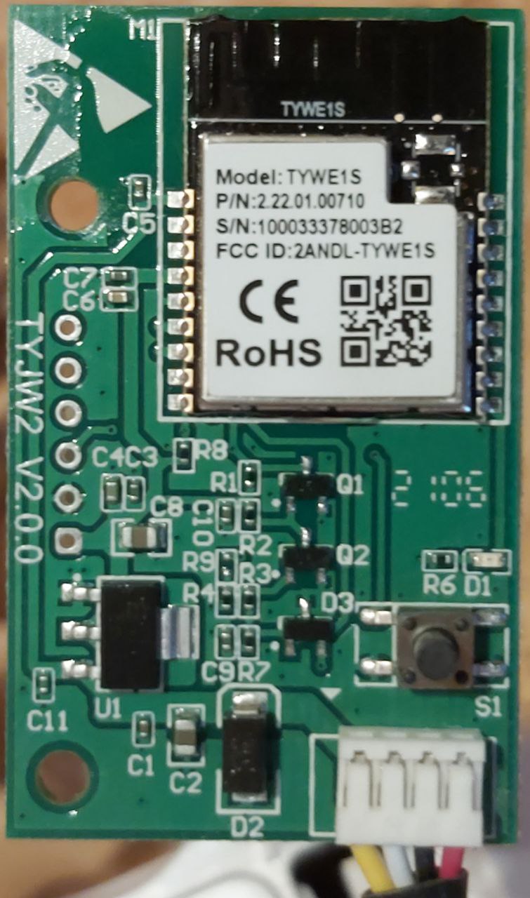

Hello.
You said that you solder the pins on the board, to connect the usb flasher.
Ok, but… Which pins?
The row of 6? Tx1, rx1, 3v, gnd ?
Or the 4 pins that used to go the AC?
Thank you for your help!
:blush:
here’s the other side :
Hi, I soldered a pin Header to the 6 pin row and it was enough space in the case so you don’t need to remove it afterwards.
The data lines are RXD0/TXD0.
I powered it up with 3.3v, it was completly disconnected from the climate Board
thank you a lot ! i just soldered the header pin too, and i’ll give it a try!
it works perfectly! thank you :slight_smile:
