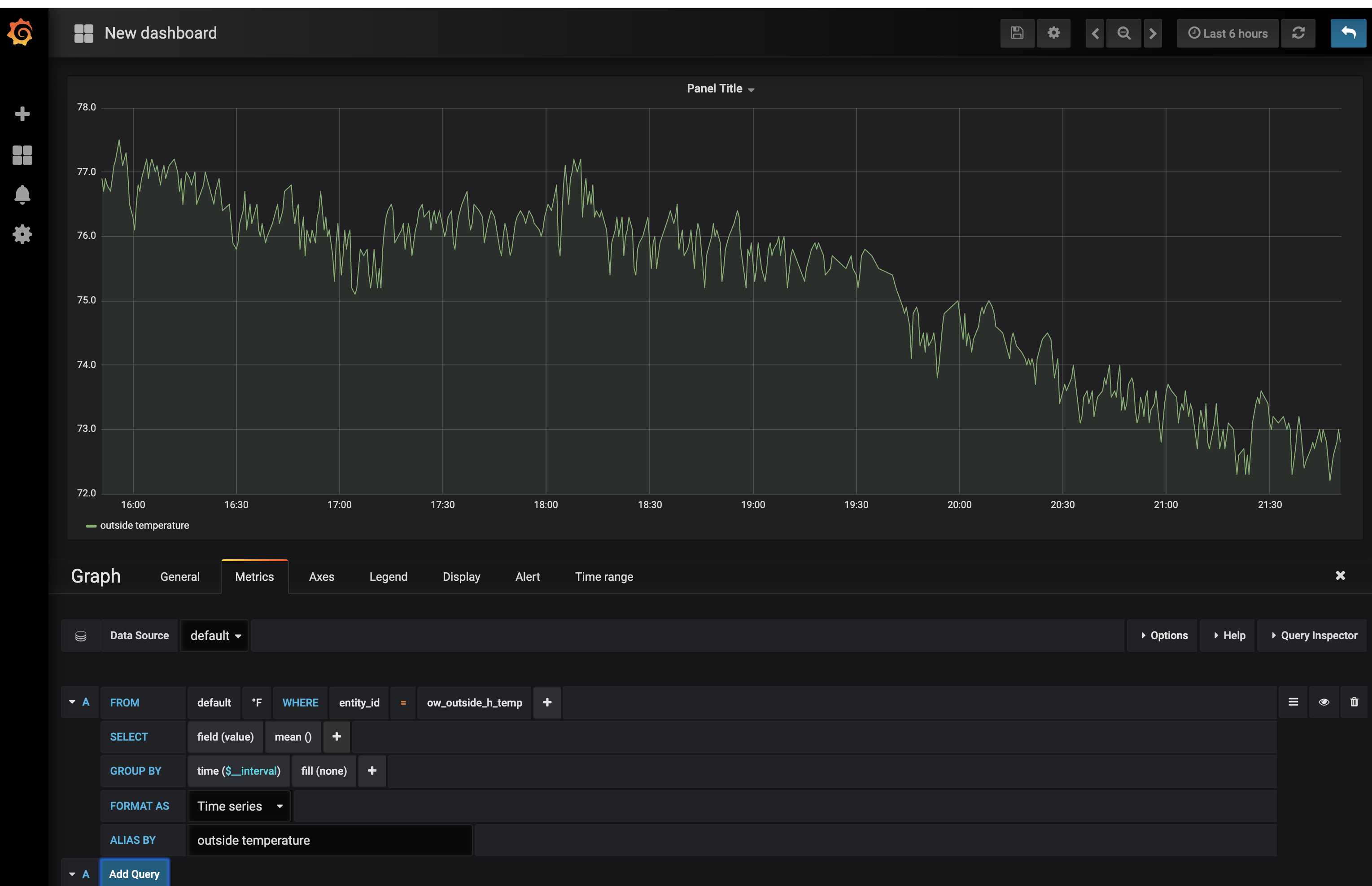

You could push your data into influxdb and point grafana at influxdb to generate pretty graphs. Or even use the influx to run queries on the data and extract a series. I have a bunch of states that get pushed into influxdb, a really nice time series database. This example is also just temperature, but I also have AC line voltage, power measurements, DC battery level of the generator’s starter battery, etc. in there.
Just a quick dashboard that took 2 minutes to set up in my grafana/influx installation:
There’s a bunch of tools at your disposal that might be a more rapid path to a solution. In my circumstance, I have Home Assistant, influxdb and grafana running in different docker containers that we each fairly easy to get setup. If you’re using Hass.io, there are probably pre-built extensions that you can click to install pretty easily.
Regardless of what path you go down (even using the home assistant database), just try to be aware of the I/O load going to the database. The SD card on a Raspberry Pi is really going to struggle if you’re trying to push a bunch of data into it. I’m running Home Assistant on a NUC-type device with an SSD, and the I/O performance is just not any issue in that environment. To help manage this, if you’re using the influxdb component in Home Assistant, you might want to be selective in only having it store the sensors that you care about in there, and not ones that changes on a frequent basis that don’t have any interesting data .

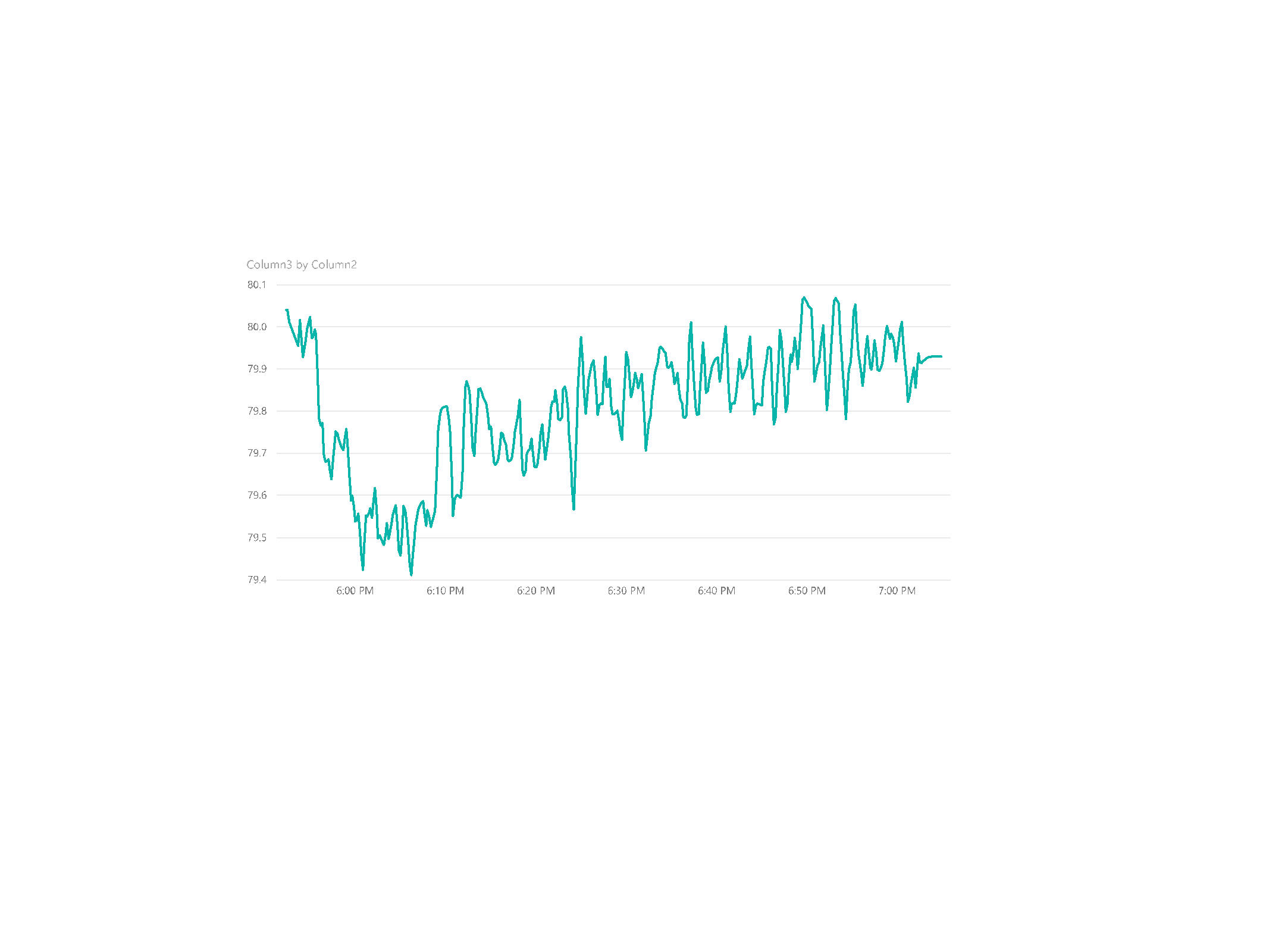

And here’s something else I’m doing as I recently discovered this great feature in the free MS Tool called Power BI:
You can link - i.e. not import - the csv-file as data source into Power BI, build your chart and then simply hit the ‘Refresh’ button once you overwrite the old csv-file with the new version downloaded. No copy/paste or re-creating graphs required:

Wow, I had never heard of PowerBI before. But then, I have been out of the professional Office user corps for 20-years (I retired early). I am using MS Office 2007- because it does all I need. (Much to my wife’s frustration when I ask her for Excel help- she is using the latest version of everything Microsoft where she works).
I installed PowerBI Desktop and in less than a minute I was able to create the same graph I made in Excel. It looks like I can save it as a PDF with the free version. Nice tool. (I have another project not related to HA that may benefit from this tool- just what I need, more stuff to learn).
I just dragged (drug? What’s the passive of drag?) my CSV file right out of my config folder into BI and it ignored the header lines that HA added.
