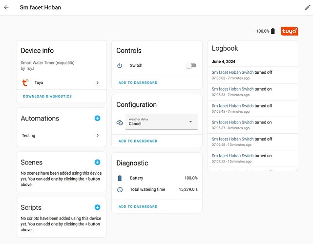

I have a Linex WiFi Smart Water Timer controlled by the SmartLife app. I also have the Tuya integration working in home assistant and it works fine for all my other SmartLife (Tuya) devices.
I can see 4 entities associated with the device (see screenshot), one of which is a switch entity. When I turn the device on and off using the SmartLife app on my phone, I can see the switch boolean appropriately turning on or off inside home assistant (see screenshots). But, when I try to toggle the switch inside home assistant, nothing happens.
Any thoughts or suggestions on why I can’t control the switch using Home Assistant?
ENTITY LIST:
SWITCH IS OFF:
SWITCH IS ON:
