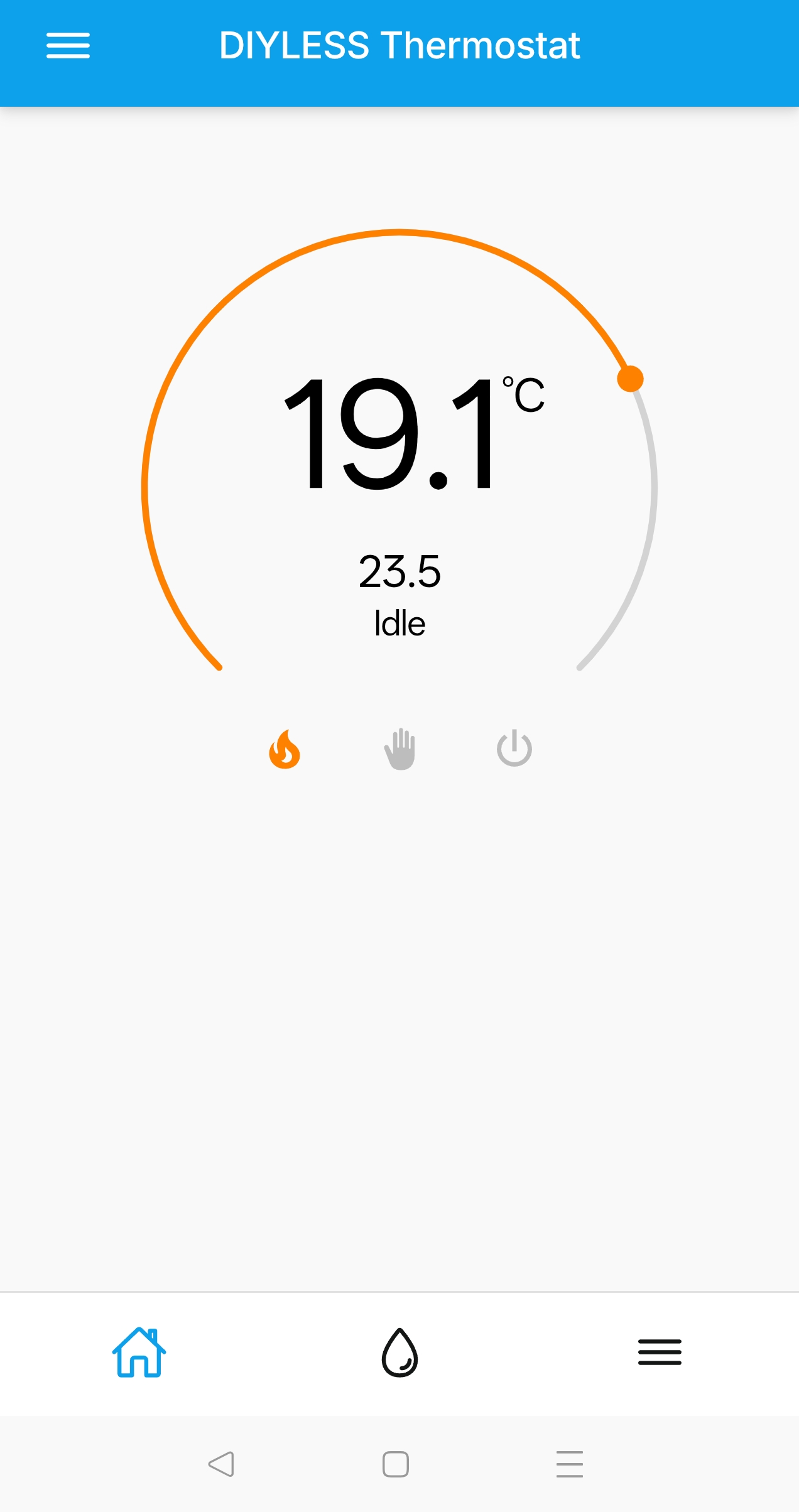

It works really well. Basically I bought the ESP32/ESP8266 Thermostat Shield complete with the Opentherm Thermomstat case and I already had an ESP8266 D1 Mini. It gives complete control of the boiler and from my previous setup I already had setup a programmer section to control timings of the heating etc.
Hope that helps you
Ian
Did you take any special steps setting up the DIYLESS? Did you do the ESP Home setup in HA? I’ve got the headless esp32 variant and it constantly says idle when in the IP interface. (I didn’t set up with esp home, just plug and play with the OT terminals.
I’ve wired it up to my boilers opentherm socket but can’t decide if I need an additional loom, to change something or if I’ve just set the ESP up wrong.
I didn’t take any special steps at all. I simply followed all the installation instructions that Diyless provided and it worked fine. The only thing I did do was use his excel spreadsheet equitherm_calc to plot the heating curve to how I wanted it.
