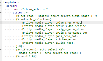

is this sutable?
No… there should be entity names not the word Entity.

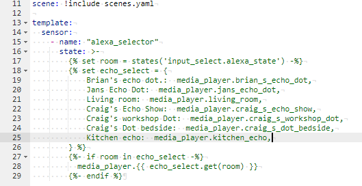

soooo like this then?
Yep. I don’t know if it counts as a big enough change or not, but since this is your first template sensor, you probably should do a restart.
i just did funnily enough wanted to add the other devices to the card dropdown so added the others and restarted t so hopefully they will work properly
I just realized that you need to remove media_player. from the second-to-last line of the template sensor. It should look like:
{{ echo_select.get(room) }} instead of media_player.{{ echo_select.get(room) }}
just like this?
