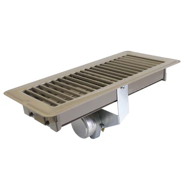

# MZR-1004-W-PC | Motorized 10 x 04 Zone Register - White | iO HVAC Controls
over this:
if the epa claims something like 10or20mm of debris in a system will take it down 20% in efficiency i can only imagine what adding things into the airflow will do.
But if your system is indeed running on the better side of things or designed or sized for these conditions. Maybe its worth it.

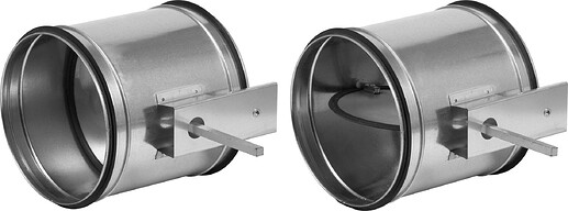

I put duct dumpers in 3 rooms of 4 and I am testing them. It works great so far! I only did 3 rooms because the basement area under it is accessible so it was easy to cut the duct and put the dumpers. I also have 110v plugs accessible in the 3 locations!
Each room has:
1 Suncourt ZoneMaster Fully Adjustable Motorized Airflow Control Zone
1 Smart Plug,DOGAIN Zigbee Smart
1 Aqara Temperature and Humidity Sensor
The 4th room (master) has only a temp sensor:
Also in the same zone there are 2 bathrooms which help with pressure relief when the 3 bedroom automations close the vents.
The algorithm is simple, if room temp is more than desired and furnace is putting heat, then close vent. If room temp is less than desired and putting cold, then close vent, otherwise open vent! The automation triggers when room temp change or desired temp change or main thermostat action change (fan, cool, heat, off).
Thermostat is a Centralite Pearl in another location, so the automation sets temp up or down to make it run or stay on fan only mode. So, when the 3 room vents are closed and master bedroom is at desired temperature, then I can just set it to fan only. During the day, the main thermostat is left alone and master bedroom may go to any temp based on the main thermostat cycles.
There are some cons, if I leave master bathroom closed, it may be hotter than master bedroom because Thermostat is in master bedroom. Also the other bathroom may reach any temperature.
Not perfect or complete but it improved sleeping comfort a lot for all of us! Also during the full day the 3 children rooms maintain a constant temperature.
I came to this site to check what options I have to put smart vents on the master bedroom and bathrooms where I do not have access to the ducts because basement is finished! The intention is to have total temperature control one day!
One thing I do not like about these dumpers is that they have an on position when closed that works by keeping the motors engaged and when power is switched off, the springs open them. But they get hot while closed, I called the vendor and he said that this is the standard way all those vents work and that if I had concerns I could add heat sinks or glue metal sheet to the duct itself. To make it quick I installed heat sinks (that I had for the 3d printer) and now they stay barely warm.
(40mm Heatsink Kit 40x40x20mm with 3M8810 Thermal Conductive Adhesive Tape, Aluminum Heat Sink Cooler TEC1-12706 Thermoelectric Peltier)
