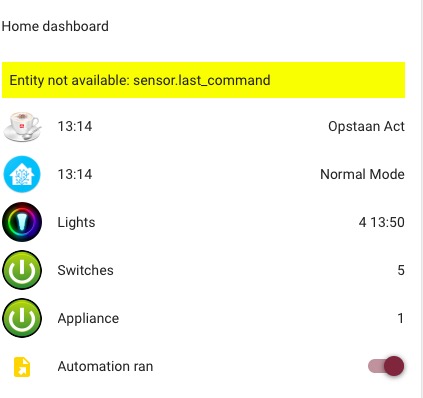

Must admit I am still a bit puzzled which badges do or dont show.
I have another set of (python created ) badges and they do show in a card without problem:
01
the top one isn’t showing, because it isnt created yet. This is a true issue with Lovelace for me still, maybe there’s a setting, I don’t know of.

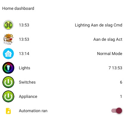

when a script is run the sensor badge is displayed:
