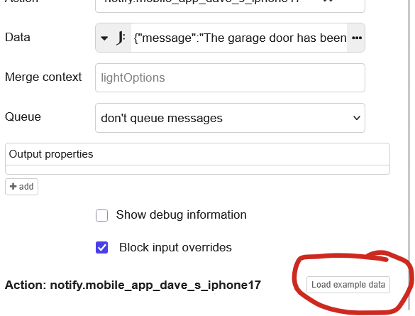

Hey, Steve. Could be the formatting. Have you tried clicking on the Load Example Data button to get a start?
Thanks for the reply, yes, I did try the example data, but even if the data were malformed, why would the node say there's a connection error?
