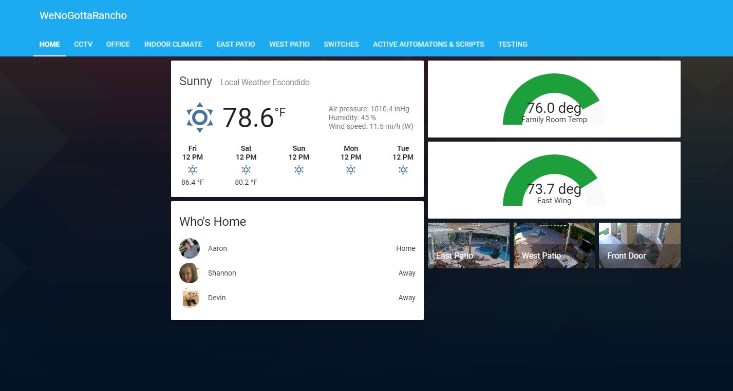

Here’s the first View… My testing page… where Im playing around is the last view… down at the bottom.
I’m in the process of provisioning devices… so its king of a mis-mash
