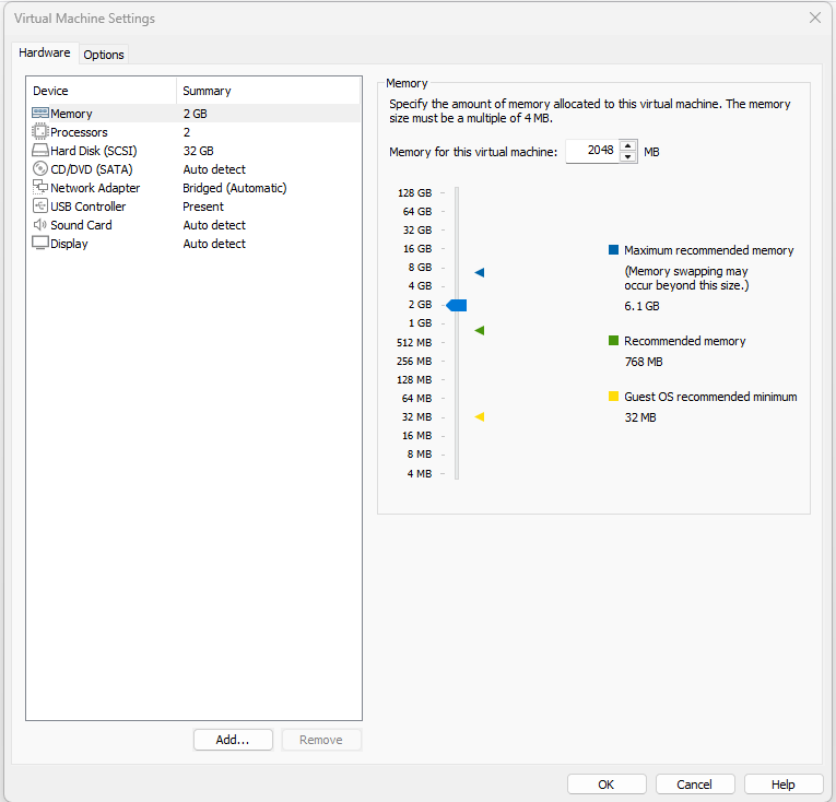

I also enclose photos of the VM settings
The error indicates an issue with the internet access.
Either there is no access at all or the DNS service is failing.
Not having a promiscous driver installed in Windows can cause this among other things.
Hi, I’ve only just got into using HA and I’m not familiar with it, could you be more precise in this info of yours?
What should/can I do to solve it?
Its not a HA thing. Its a VMware/Windows thing related to the network card.
Sometimes it can be a setting on the network card other times it can be a different driver.
There might be other ways too and there might be settings in VMware too, but I have not worked much with VMware and never on Windows.

I succeeded.
It was all an IP problem.
After creating the VM and before starting it, on the router I set the IPs, via MAC Addresses, of both the physical networks (lan and wifi) of the minipc and the virtual one of Virtualbox.
When the VM started up, the error did not occur and HA started.
