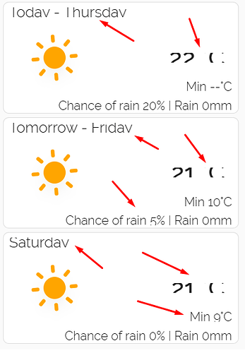

I’m a “tinkerer” of CSS (rookie), and I just cant seem to set the “overflow” to “visible” using card mod. (assuming that’s what I need to do to fix this? or perhaps something to do with setting the element size???)
I have a problem with some customization I’ve done to create a custom weather card(s) using a Mushroom Template card.
Here is the problem: The text gets chopped off.
when I look in dev-mode, and change the “overflow” from “hidden” to “visible” it fixes the problem:
if anyone can please assist in how to set the “overflow: visible” it would be greatly appreciated
if you’re interested here is my code:

Add --card-primary-line-height: to match the --card-primary-font-size:
card_mod:
          style: |
            ha-card {
              --card-primary-font-size: 25px;
              --card-primary-line-height: 25px;
Legend!!!
Thanks so much. Worked perfectly!
