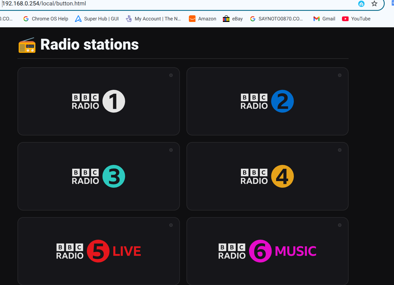

I’m in the process of setting up the Facebook portal; take a look at my GitHub. It’s still a work in progress, but I have a radio screen with 6 buttons to play BBC radio stations via Music Assistant. See GitHub - lone-baggie/View-Assist: Custom Dashboards and blueprints for View Assist · GitHub. I have some HTML pages that do the same thing; see GitHub - lone-baggie/HTML-views-for-Home-assistant: Display home assistant data via HTML web pages · GitHub .

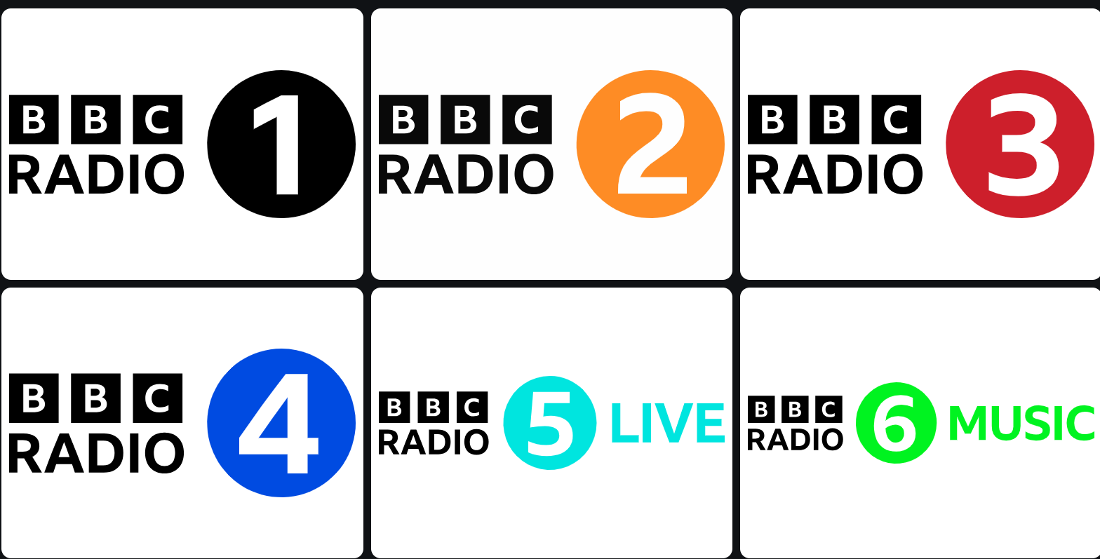

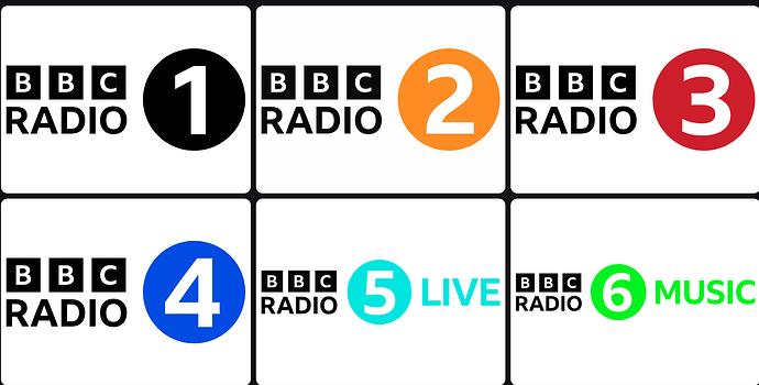

Have a look at GitHub - lone-baggie/View-Assist: Custom Dashboards and blueprints for View Assist · GitHub. If you create a new dashboard in Home Assistant. Then edit it. Click on the three dots in the right-hand corner and select raw configuration editor’. Delete whatever is in there and copy the contents of View-Assist/Dashboards/dashboard.yml at ff3f39d7a4a070d6c49b93f8f735a32745ab61d2 · lone-baggie/View-Assist · GitHub . This is a complete View Assist dashboard. The radio view is here View-Assist/Dashboards/radio.yml at ff3f39d7a4a070d6c49b93f8f735a32745ab61d2 · lone-baggie/View-Assist · GitHub. The icons are here HTML-views-for-Home-assistant/HTML at main · lone-baggie/HTML-views-for-Home-assistant · GitHub There is also a HTML radio page . Instructions are here GitHub - lone-baggie/HTML-views-for-Home-assistant: Display home assistant data via HTML web pages · GitHub. Here are some screen shoots
