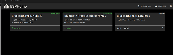

If you look at the picture, the one on the left, 42b3c8 is the one I didn’t “adopt”, that one was set up 100% with the ready made site.
The one all the way to the right, is the one I “adopted”. Notice it gives the name of the file with the .yaml extension.
The one in the middle is the one that I don’t understand. By the f57fa0 I can tell it is referring to the same esp32 that I already adopted. Why does it want to re adopt itself?
